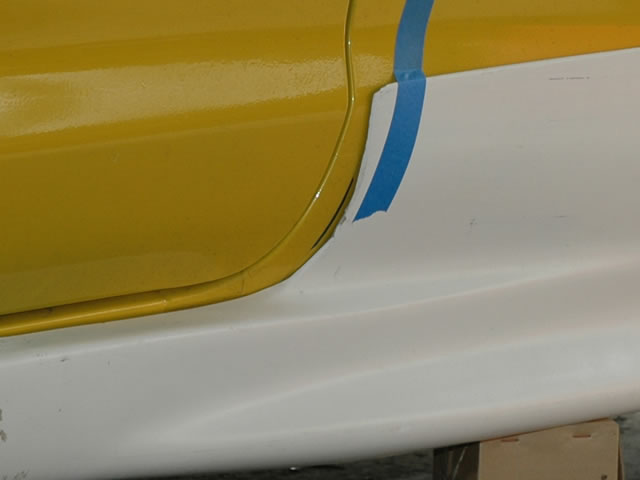

Over the weekend, I began doing bodywork on my Celica. I've got a few questions though.
1. How do I remove the two rear side windows?
2. Are the door handles difficult to remove? How do they come out?

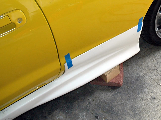

3. My sideskirts have large areas right behind the doors that need to be filled, pictured below. What's a good plan of attack to fill these areas?

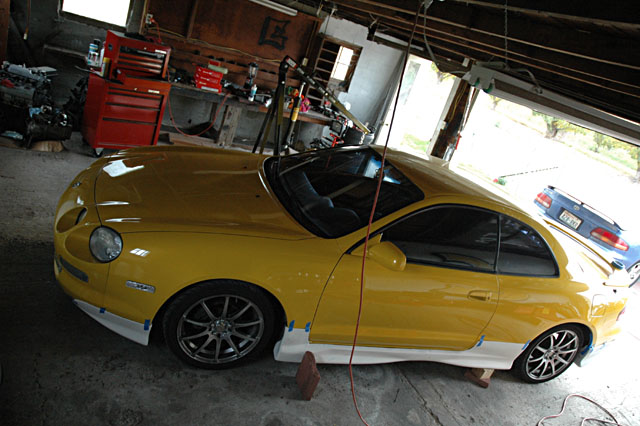

- - defgeph   whats skirts are those ?   Oct 16, 2005 - 11:55 PM
|- - Coomer   QUOTE(defgeph @ Oct 16, 2005 - 9:55 PM)whats ...   Oct 17, 2005 - 12:01 AM
|- - OrbitalGT95   QUOTE(Coomer @ Oct 17, 2005 - 5:01 AM)QUOTE(d...   Oct 17, 2005 - 7:20 PM
- - o0black0o   Z-Max I think   Oct 17, 2005 - 12:00 AM
- - defgeph   cool man looking great.   Oct 17, 2005 - 12:06 AM
- - CelicaBuddy   OooooOOOOoooh! Looks great!   Oct 17, 2005 - 10:32 AM
- - CelicaZR   Looking good Coomer   Oct 17, 2005 - 10:34 AM
- - Chanh55   Lucky bastard... Look at that huge garage!   Oct 17, 2005 - 10:39 AM

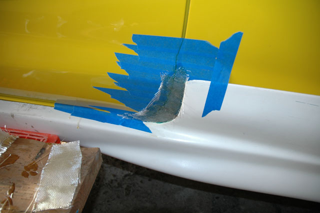

- - madmods   I would cut a square section off the top, move the...   Oct 17, 2005 - 11:37 AM
- - azian_advanced   are all z-glyde skirts like that? i sure hope not...   Oct 17, 2005 - 11:54 AM
- - Jaws4God   Looking Good!! Keep Us Updated!!...   Oct 17, 2005 - 11:40 PM
- - Coomer   Thanks for the comments and help guys. I fiberglas...   Oct 18, 2005 - 1:07 AM
