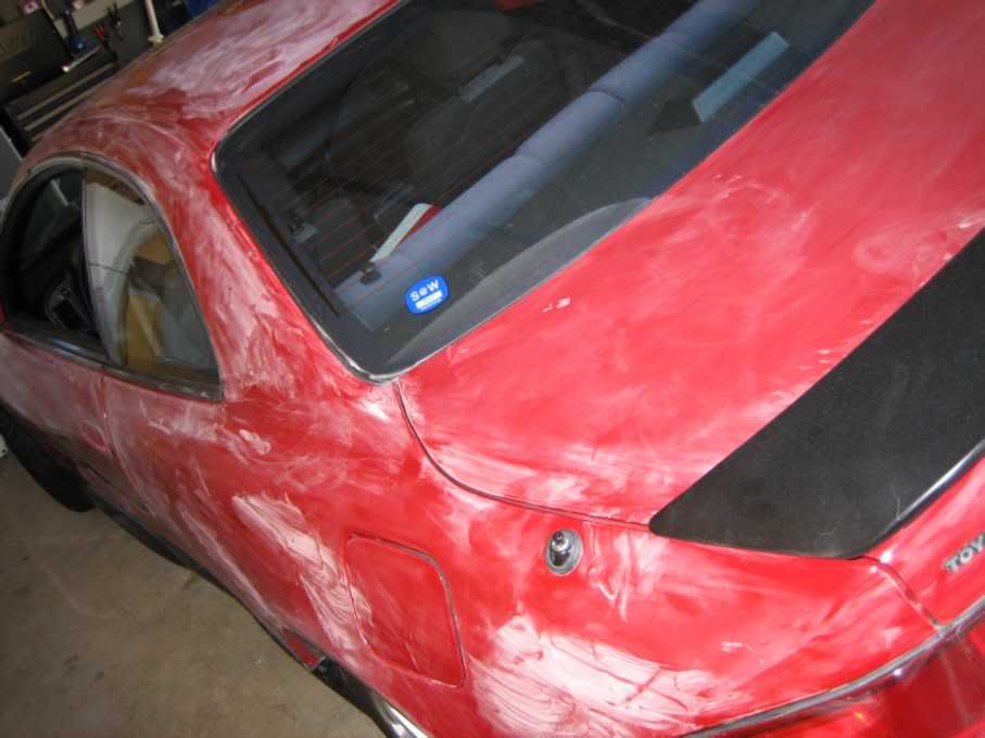

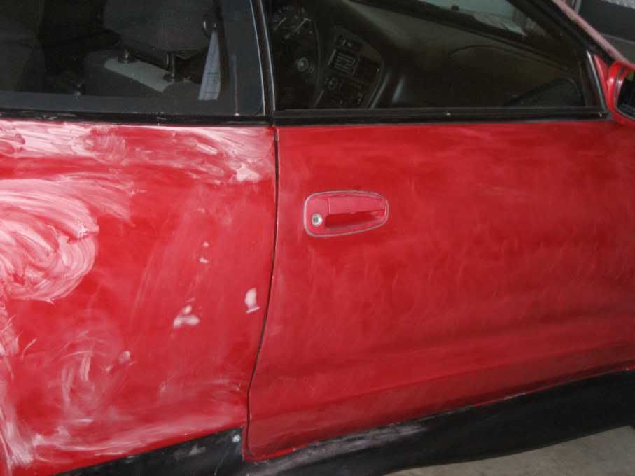

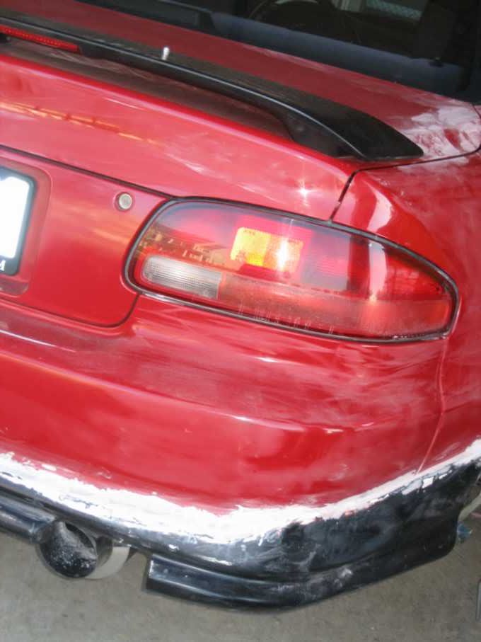

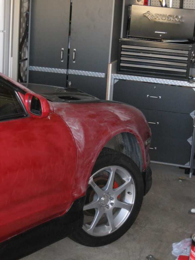

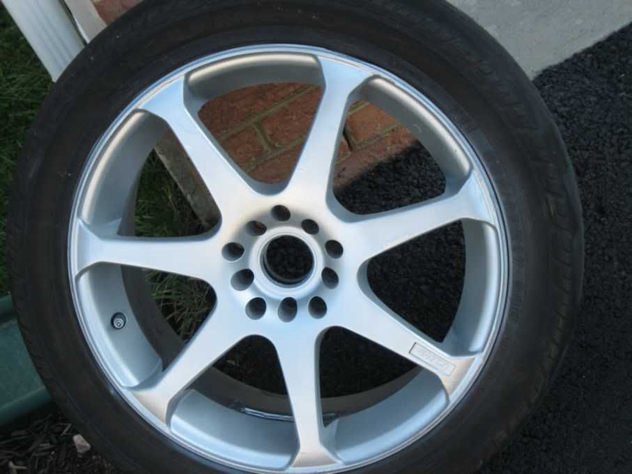

Well i bought another car, an infiniti i30 limited. So i decided it was time to paint the celi so first i needed to wetsand it and get all dings out. I also am molding rear bumper. Also refinished my wheel.

looking good, nice job......um i have a question though, you know you should try to sand the same direction right? Just asking cause it looks like you just sanded......but your doing a good job I give credit to anyone who does the prep work.......r u gonna paint it? biggrin.gif

was going to paint it but, didn't have time to get compressor and gun. (work is hectic right now). hmm didn't know about same direction thing didn't read that any of the places i did some research, its still not perfect but i'll take it same direction for last sanding.
