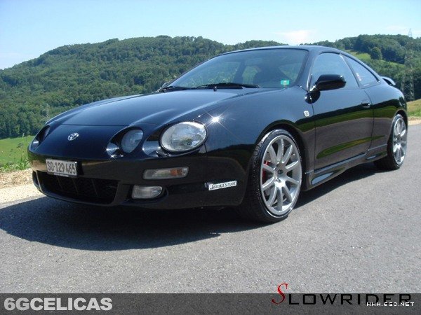

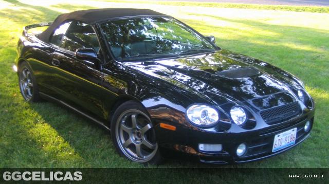

The measurements are all calculated from two cars and the information they provided me. You have to remember these are recommended offsets to get it as flush as possible with no need to roll fenders or worry about strut clearance. jgreenings car had 1mm of room in the rear lowered on TRD springs which are about a 1.75 inch drop. Slowriders car looks pretty damn flush if you ask me. All of this is in the begining of the thread if you'd like to read it.
Slowriders for stock ride height:
jgreenings convertible lowered on TRD springs:

Slowriders car is clearly lowered though, and in his profile it says he has lowering springs. And that's what I meant about everyone's definition of flush being different. Slowrider's is probably as flush as possible without rolling the fender, but to actually be flush it needs spacers, 10 mm in the front and 20 mm in the rear.
This is what I would consider flush, 18x8 +35s with 20 mm spacers, so an overall +15 offset.

See, in my opinion that sticks out too far... especially in the front. That's about an inch difference to what the guide says which would be about right in my opinion. To each their own I suppose. We have a separate flush fitment guide if that's what people want. If they want no hassle fitment they can look here.
