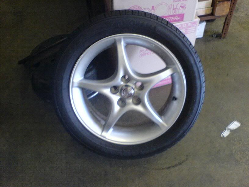

QUOTE(BlackSTX @ Jan 14, 2006 - 1:22 AM) [snapback]378027[/snapback]
There are 15" alloy 7th gen rims too. They're not five spokes like the 16" though.
oh yea forgot about those.
I was just thinking of the gts/zr wheels.
But they do have a 15" version for the
lower spec 7gen (sx) which look like
these
and these are the 16"
6GC 4 Life Baby!!!
