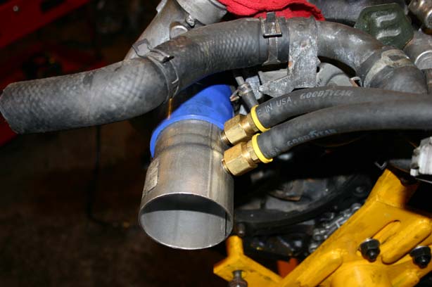

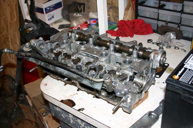

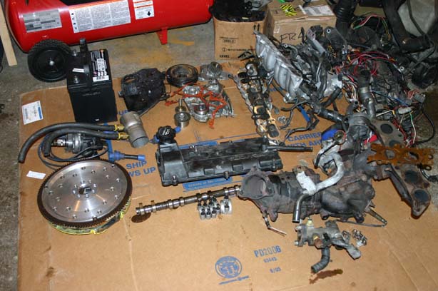

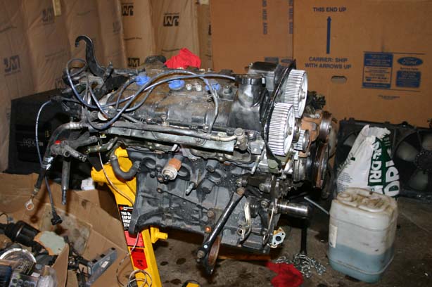

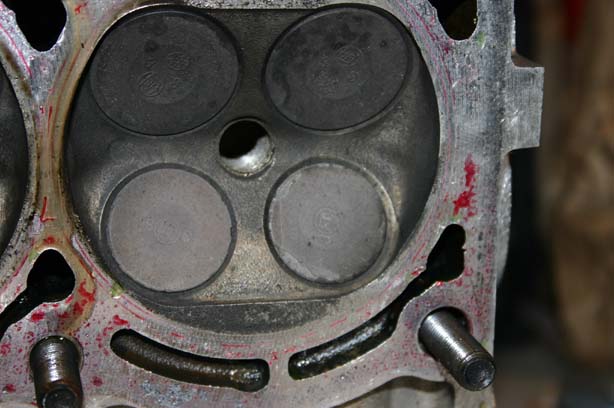

I figured I'd show you guys what I've been doing out in the shop. I posted about this car a while back ('92 GT auto, conversion to manual and 3SGTE swap), here's the latest on it. (Posts copied and pasted in order).
Basically, yesterday I put everything together and I wasn't able to get it started due to no spark. After tracing it out and writing a thread on Celicatech, http://www.celicatech.com/forums/showthread.php?t=13806, I figured out that the coil was bad, and the coil and ignitor weren't grounded well enough. After fixing that, the engine fired right up (early this morning). I went to bed and then came out to the shop at around 3 this afternoon, to start it up and do the first phase of engine break-in. The first problem I had was that the engine would start and run for a second and then die. For some reason, the fuel pump isn't staying on after the engine starts. I jumped it at the diagnostic connector and will deal with it later. After fixing a vacuum leak the engine started running beautifully! But then... While Niki was in the car holding the engine at a stead 2000 rpm and watching the temp, I kept an eye on the oil pressure and any leaks. After the engine ran for a few minutes, I noticed a puddle forming on the ground under the front of the engine. It was pretty minor so I left it for the time being, but then, we started getting a major leak from the rear of the engine. I slid under the car and took a look, and oil was spraying all over the back of the flywheel and dripping down. It soon became apparent to me that the rear main seal was leaking badly, along with a seal at the front of the engine, possibly the crank seal. After thinking over my options, I realized that the only way to get it fixed was to remove the engine. First, I drained the oil and got another nasty suprise. The oil was very milky, and when I put Speedi-dri on it, it turned green... seems like the coolant was getting into the oil. Seems to me that perhaps the head gasket wasn't installed correctly? Is there any other way for the coolant to get into the oil? So, I busted my butt and pulled (rather, dropped) the engine in just over an hour, pulled the tranny, put it on the stand, pulled the front of the engine apart, along with the rear. First thing I noticed was that the timing belt was loose, the cam sprockets had actually jumped a tooth, the dots did not line up! I was able to just pull the belt off by hand without taking the tensioner off. Thankfully it was just one tooth each so the engine should be okay. Seems like the tensioner wasn't installed correctly.... Then I put my air ratchet on the oil pump and cranked it, got the pressure up to 50 psi, and sure enough, oil was spitting right out the bottom of the rear main seal. It's brand new, I don't know why it's doing that. Also appears that the front main seal is allowing oil by. So, my plan is to replace the front and rear main seals, the oil pump gasket, and unless I come up with another reason for coolant in the oil, the head gasket. I got the whole front, rear, and bottom of the engine pulled apart, along with the intake manifold removed. Monday is when I'm back in the shop, I'll pull the exhaust manifold and the head in preparation for the parts. The good news is, the engine DID start and run, and it sounded good at the time! ------------------------ So today I finished removing everything so that it's ready to go once I get the parts in. Here's what the engine looked like at the end of the day yesterday: ![]() ![]() Ruel, if you're reading this, I'm going to redo the two air lines for you like this, when you come up for the E153. ![]() Check out the flaking on this exhaust valve, you think it might be a problem? ![]() The pile of parts... ![]() The block all cleaned up: ![]() ![]() And the cylinder head. I did have to remove the intake cam to access one of the bolts, just because the tool I was using was a little too fat to get a good angle on the bolt head with the cam in the way. ![]() ![]() Next week I'll have some shots of it going back together -Doc This post has been edited by Dr_Tweak: Jan 23, 2006 - 12:37 AM -------------------- -Dr Tweak, 6GC's resident engine swap wiring expert extraordinaire Click here to see my swaps drtweak@phoenixtuning.com |

Silver94CelicaOwner Looks and sounds like a lot of work got done. Gre... Jan 23, 2006 - 2:19 AM
Dr_Tweak Oh yeah, well those are the air lines for the IAC ... Jan 23, 2006 - 2:34 AM

Silver94CelicaOwner Thanks for the explaination Doc, I really like tha... Jan 23, 2006 - 11:07 AM

lagos where did yo find those fittings for the intake. i... Jan 24, 2006 - 12:03 PM
Dr_Tweak Right at my local parts store Jan 24, 2006 - 11:44 PM![]() ![]() |
