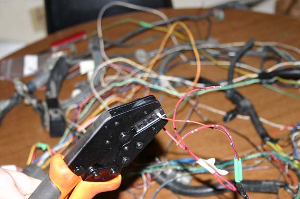

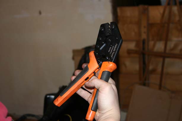

After reading Jeff Hartman's recommendation to use a crimper, I decided to look into it. Now, make no mistake! I'm not talking about those little baby crimpers that you buy at Pep-boys with the little insulated terminals. I'm talking about a full-fledged, expensive, professional, racheting crimper with non-insulated crimps. The other day I finally got the set that I needed (after ordering a set and getting the wrong ones!), and today I got to put them to use. smile.gif
Check these baby's out:

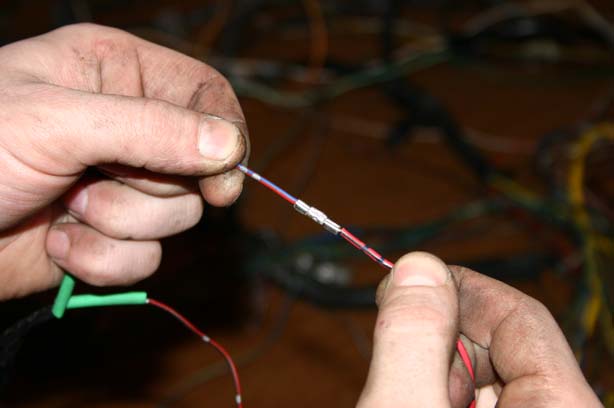

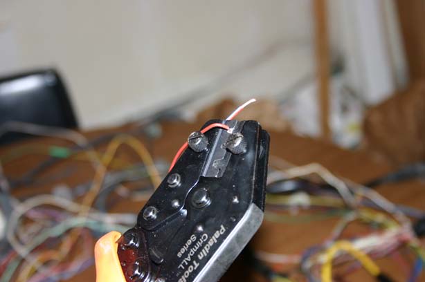

Crimp one wire...
Then the other...

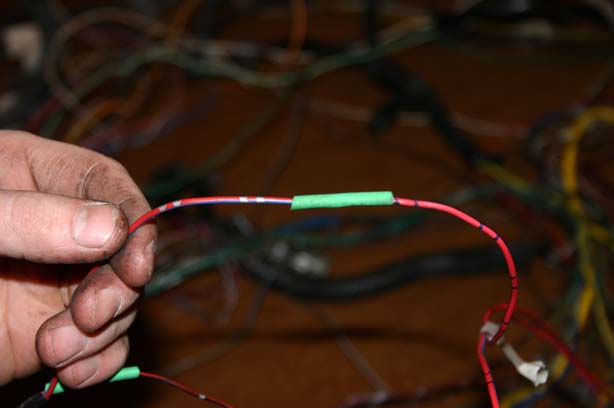

Completed crimp! This thing is SO strong, that the wire will tear before the crimp fails. And it'll never corrode.
All ready for heat shrinking:
One last thing. These things crimp so hard, that I have to use both hands!
