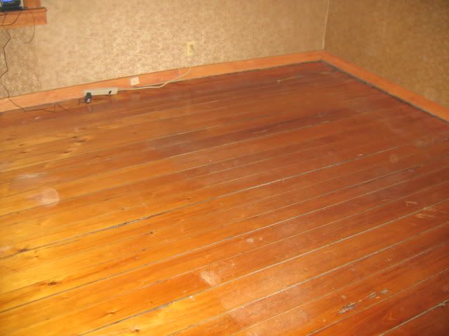

first, a couple pics of the pre-exsiting floor:
this floor is OLD southern yellow pine, very typical in this area, and mostly used as a subfloor. the gaps between the boards are quite large (some over 1/4") and that would let cold air thru from the basement (i live in a 1st floor apartment) not good in the winter, at ALL. lol

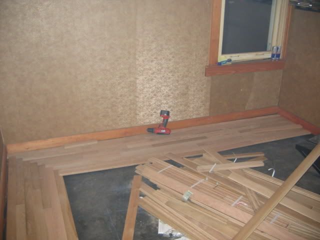

i had some red oak left over from previous jobs, so i decided to use that as the border, and "mill-run" maple as the center.

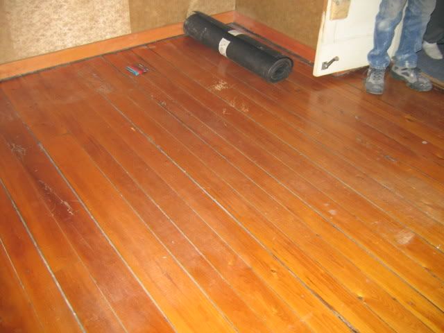

so, i layed down some 30lb roofers felt, to cover the gaps, and to help stop squeeking ect later on down the road, and started laying the first board:
then continued on with the border from there:

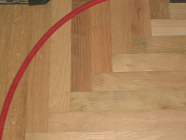

a close up of the border:

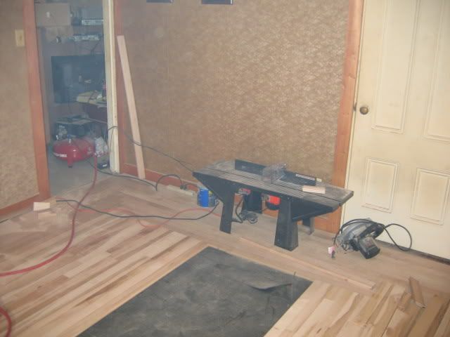

once the border was laid, i started filling the center with the maple:

why a staggered joint in the corners and not a loose tunged mitered joint ?? plus what finish did you use on it, you got a great finish smile.gif

pop, i had never tried the staggered look like that before, something new.
