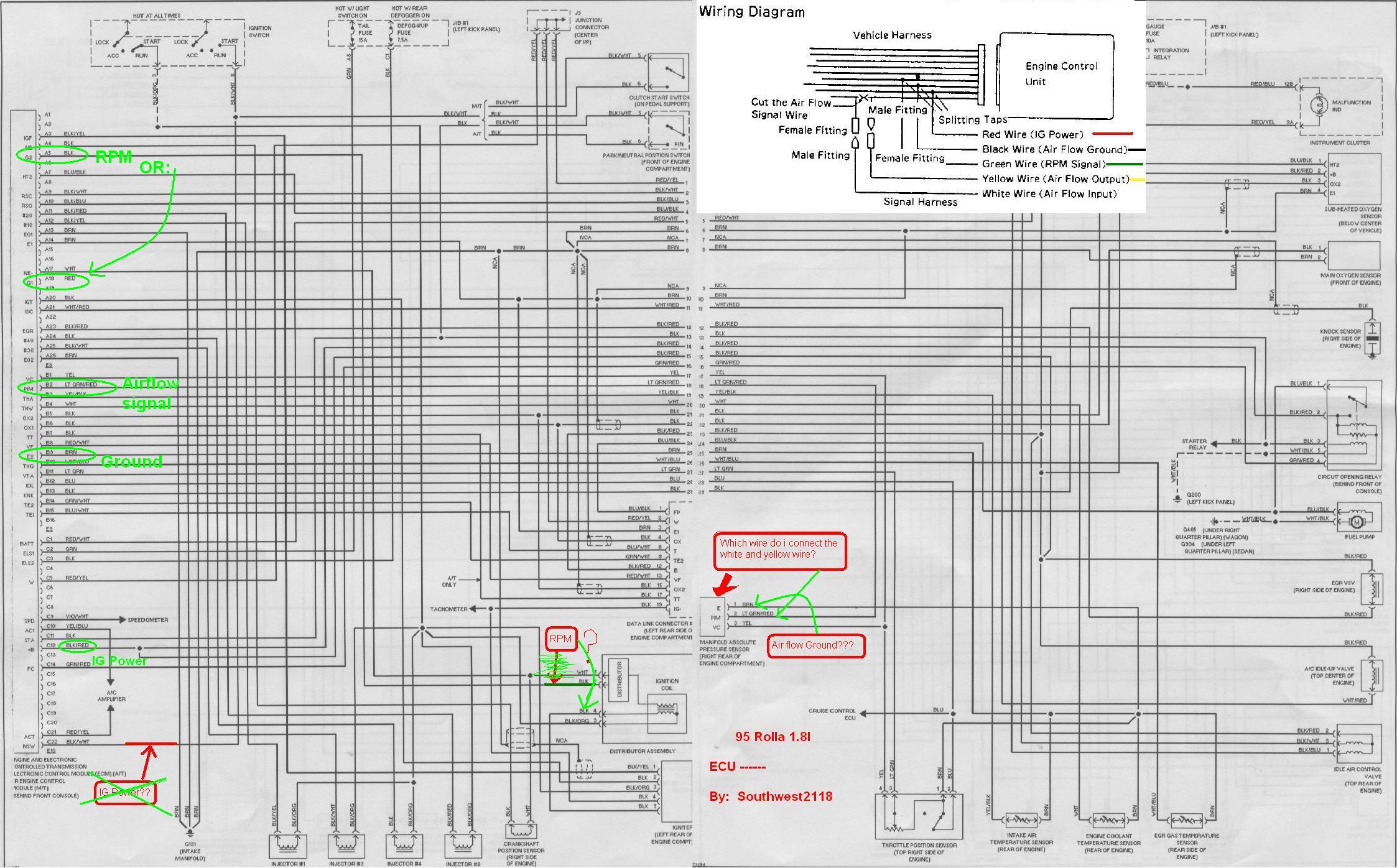

Can some body help me find what to set the "Type select" & "Car select" on the first gen safc. I looked every where but can't find anything. or what will be close? http://www.apexi-usa.com/pdfInstallation/4.pdf
its for the 95 7afe corolla.

This should be right.

biggrin.gif biggrin.gif hey thanks doc biggrin.gif biggrin.gif so for rpm i need to run a wire to the engine? no signal gose to the ecu?
do you know any thing about the "Type select" & "Car select"? i know its pressure but what is that?

Hmmm, according to the diagram in the instructions, you can also tap into G1 or G2, which makes sense. (You have G2 in your diagram). I'll make you a new diagram in a minute.
For the car setup, you want:
down up down down up down up down

WOW smile.gif how do you know that.........what about the TYPE SELECT?

QUOTE(southwest2118 @ Mar 6, 2006 - 8:35 AM) [snapback]403246[/snapback]
Sorry, that IS the type select, for the car select I'm not sure, I don't see anything on it in the manual, where's the explaination of it?

oh ya that is. on the type select what car is that for in the manual?
it has to be 1, 2, or 3?

Corolla, 4AFE. Same for all cars with a Denso pressure sensor.
Here's the updated version:
Car Select: 3, I just saw that now.

hooking up g1 would be pretty hard since i don't have a male plug?
so it looks like all the "A" "B" "C" are the three harnesses?
do you have a link to the manual you are using?
i'm going off this http://www.apexi-usa.com/pdfInstallation/4.pdf

You're just tapping into the G1 or G2 wire, so it should be easy. Yes, there's the A plug, B plug and C plug. The A plug is the big 26-pin, the B is the small 16-pin, and the C is the 22-pin.
I was looking at that link you posted.
