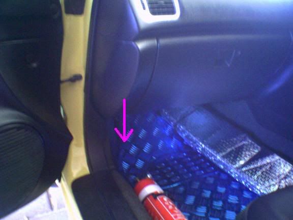

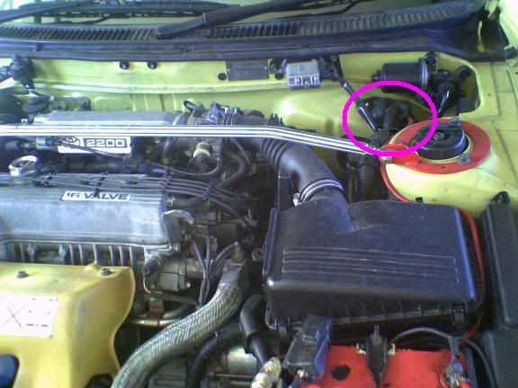

Here's where I ran mine. (Keep in mind mine is RHD)
Made a small slit in the ribber boot circled in purple, and just fed the wire through.
I took the glovebox out to make it easier, and after feeding enough wire through, it came out here, behind the glovebox. (Following the path of the arrow). Then just ran it under the side carpet to the boot.
