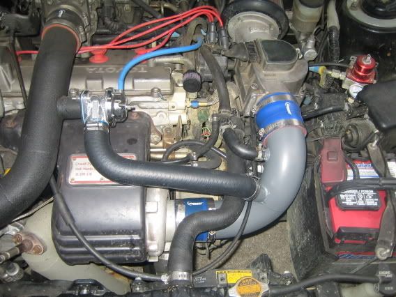

Today Carl at Speed Source made me a new intake so I could recirculate my Greddy BOV. Here are the results:
All in all, a great mod - unless you like the sound (which I don't).
Here are the pics:

- - CheesyLobster   wow. if i swap a 3s i will definately have to do t...   Jul 7, 2006 - 10:26 PM
- - zipstrips   ive been wondering if any swappers were going to d...   Jul 7, 2006 - 10:33 PM
- - jgreening   Greddy type RS   Jul 7, 2006 - 10:46 PM
- - lagos   post pics...NOW! ask him to make one for me...   Jul 7, 2006 - 10:58 PM

- - jgreening   bump for pics.   Jul 15, 2006 - 2:09 PM
- - playr158   very nice and clean looking   Jul 15, 2006 - 2:20 PM
- - Kadett   Nice... almost looks stock   Jul 15, 2006 - 2:22 PM
- - defgeph   sweet, looks great Jay   Jul 15, 2006 - 2:51 PM
- - brianforster   now im even more jealous that you cant get these m...   Jul 15, 2006 - 4:23 PM
|- - jgreening   QUOTE(brianforster @ Jul 15, 2006 - 4...   Jul 16, 2006 - 3:09 PM
