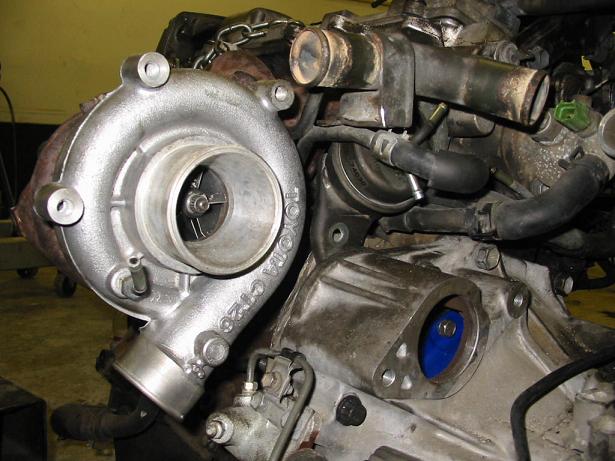

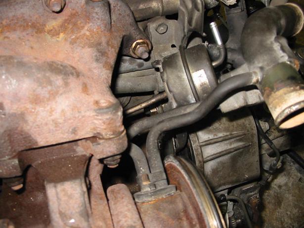

This is the wastegate bracket that I designed so that I can clock the turbo on 3SGTE engines.

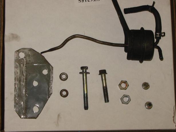

What we have here is the bracket, two longer bolts which replace the ones that go on either side of the started (from the transmission side), two spacer nuts, two small bolts for the wastegate actuator, and two nuts for the bracket itself.

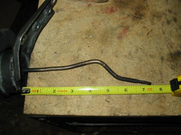

Here we see the modification that must be made to the actuator rod. This shape has worked well in all of the tests that I've done. The finished length is exactly 7 3/8".

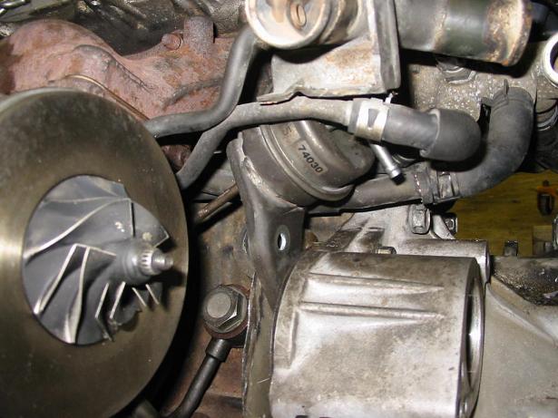

Here we can see the longer bolts installed through the tranny, and then the large spacer nuts, followed by the bracket, and nuts that holds it tight. The bracket seems thin in this picture, but when it's all installed it's very strong.

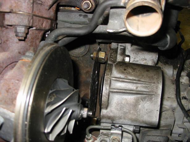

Then the actuator is installed between the bracket and the tranny, and the bolts are installed through the bracket and they bolt into the stock locations on the actuator.
Here is another view. You can see that you have to wait until this is all installed before you can reinstall the compressor housing of the turbo. Also in this view, you can see that the part of the water line housing that used to bolt to the compressor has been cut off. I have always removed it and it functions fine without the extra support.

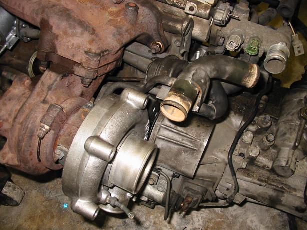

And now two pics of the finished product with the housing installed. You can rotate the outlet on the housing so that it faces where you need it to very easily.

so wait... this bracket bolts to the tranny?
ive also seen it done where people make a different style of bracket thats ticker and bolts to the compressor housing.

QUOTE(lagos @ Aug 23, 2006 - 10:11 PM) [snapback]472138[/snapback]
That's how I did the first one that I made, but the problem with that is it's much harder to fit, and often times the stock bracket has to be cut, modified, welded, etc. This way it pretty much bolts right up.
I would probably have a batch of these made up by a machine shop, and I will most likely use slightly thicker metal for the retail version. I doubt that I will charge any more than $30 shipped for them including all the nuts and bolts, unless they turn out to be a lot more expensive to make then I expected.
