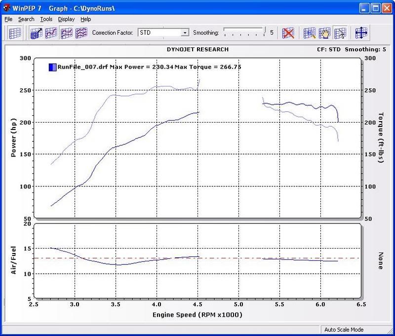

went to a local dyno day and did some pulls. there seems to have been a problem with the ignition pickup, so some of the data is missing from a few of the runs. they ended up giving me about 7 runs total for 55bucks (not bad)... but i only ended up with a few useful ones. next time im bringing a video camera with me to record my gauges and wideband while i dyno so that i can remember exactly what boost level i was at for each run.
this would have been my best run, but as you can see the ignition pickup dropped out during the run. grrr.
this one is probably the best and cleanest run, with no data missing.

nice, actually if you take the first graphic to a math professor, he will read that missing info as " power goes to infinity " so not bad at all

i was talking to nuke, and he seems to think i can gain a nice 20hp if i add more fuel at the same boost level as that 1st sheet that i posted. woot!

Any tuning there? Why is it so lean?

QUOTE(jgreening @ Nov 5, 2006 - 1:12 PM) [snapback]499632[/snapback]
QUOTE(lagos @ Nov 5, 2006 - 3:03 PM) [snapback]499626[/snapback]
I thought less than 14.7 is considered rich? the second run looks rich to me, do i have this all wrong? please correct me if im reading it wrong. kindasad.gif

QUOTE(jgreening @ Nov 5, 2006 - 4:12 PM) [snapback]499632[/snapback]
no tuning. bone stock. i have no idea why its running out of fuel. i read on mr2oc before that on some cars, the afm never goes to 100% open, so maybe thats the problem there. i think that run was at about 15psi while the 2nd one was at 13psi, yet the hp didnt change because in the 15psi run, i didnt have enough fuel.
QUOTE(eggman40 @ Nov 5, 2006 - 4:37 PM) [snapback]499639[/snapback]
14.7 is stoich. on a WOT run, you want the a/f ratio to be in the 11-12s. 13-14 would be considered too lean while under full boost. the 1st run posted is a little too lean, while the 2nd pic is perfect at 10-11afr

Any tuning there? Why is it so lean? [/quote]
[/quote]
14.7 is stoich. on a WOT run, you want the a/f ratio to be in the 11-12s. 13-14 would be considered too lean while under full boost. the 1st run posted is a little too lean, while the 2nd pic is perfect at 10-11afr [/quote]
Thanks for clearing that up for me man, Im still trying to learn this whole a/f deal, and you've provided a great example here. thank you smile.gif

QUOTE(lagos @ Nov 5, 2006 - 4:03 PM) [snapback]499626[/snapback]
That doesn't make sense. The first run you looked lean, AFR's around 13-14. The second run you appeared to have more fuel, AFR's around 11-12. With more fuel you lost a little HP and 20ft/lbs of torque. The second curve looks good A/F wise I would say another pound or two would be about as much as you could safely run with your setup as it is. Put some 103 octane in the tank and turn it up 5 pounds and see what that will get you. biggrin.gif

QUOTE(kbprice @ Nov 5, 2006 - 6:52 PM) [snapback]499678[/snapback]
sometimes not enough fuel will loose you HP. leaner doesn't always make more power. in the 2nd pic, i was at about 13psi. the car made a peak hp at:
RPM / HP / TQ / A/f
5.60 / 229.98 / 214.76 / 11.39
then in the 1st pic, the boost was somewhere around 15psi the A/f ratio went leaner, yet the power didnt change at all. the idea is, that if im running more boost, and i add more fuel, i should gain some power.
RPM / HP / TQ / A/F
5.60 / 230.14 / 216.02 / 12.78
This post has been edited by lagos: Nov 5, 2006 - 8:15 PM

QUOTE(lagos @ Nov 5, 2006 - 8:06 PM) [snapback]499702[/snapback]
RPM / HP / TQ / A/f
then in the 1st pic, the boost was somewhere around 15psi the A/f ratio went leaner, yet the power didnt change at all. do the idea is, that if im running more boost, and i add more fuel, i should gain some power.
RPM / HP / TQ / A/F
True. I didn't realize you backed down the boost on that second run. What octane fuel did you run?

QUOTE(lagos @ Nov 5, 2006 - 8:20 PM) [snapback]499708[/snapback]
93 pump gas
Try some Sunoco 103 next time and up the boost to about 17-18psi. That will about max out the ct26.

QUOTE(kbprice @ Nov 5, 2006 - 10:24 PM) [snapback]499710[/snapback]
93 pump gas
the idea was to do it on pump gas I imagine.. good numbers man.
post Nov 5, 2006 - 10:44 PM
yeah, i would try some race gas for a fun joy ride, but im looking for daily driven, pump gas power.
post Nov 5, 2006 - 10:54 PM
Sunoco has 100/103 as a pump gas not really considered race until you pass 105..atleast in my area
the curves look good Art..although it does look like your loosing some around the 3,500 mark from goin down into the 10s

QUOTE(playr158 @ Nov 5, 2006 - 10:54 PM) [snapback]499759[/snapback]
it dips down like that at almost any rpm range when boost comes on. i think its throttle enrichment by the factory ecu. you cant really tune it out.
