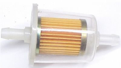

1. Will any inline fuel filter (like the one pictured below) work with my stock fuel system? I don't like the location of the stock fuel filter and want to run an inline unit mounted near the lower part of the firewall.

1) the inline filter you showed will not work. The reason is because that fuel filter is for a carberated engine and does not need to handle the psi our fuel injected systems are under. But i would assume another fuel filter for another fuel injected car will work, after all its just a filter.

for the fuel filter just get the screw in kind thats the right size of fuel line, now put 2 short peices of fuel line on both ends and bubble flare the ends not in the filter. now bubble flare the fuel lines on the car and then use short peices of high psi rubber fuel hose and hose clamps to hold it all together.
