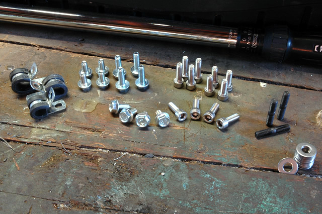

It started with a trip to the hardware store to get some supplies.
There's my $9.71 worth of hardware. All of the allen head bolts are stainless steel.

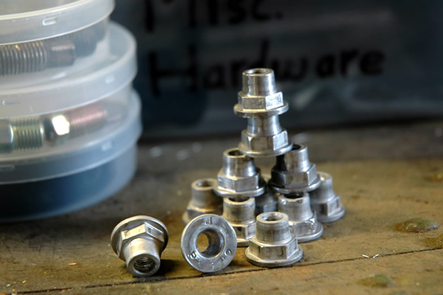

And speaking of hardware, does anyone know why Toyota would use these aluminum nuts to hold clamps that hold brake lines to the firewall? They're the only aluminum nuts on the sixth gen. Celica as far as I know, and I didn't see these aluminum nuts on any Toyotas in the junkyard. Just thought it was kind of interesting.

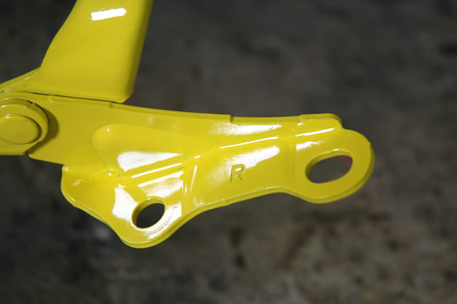

Anyway, I had to paint the hood hinges before I could throw the fenders on.
There you can see some detail on a hood hinge. I shot them with a rattle can.

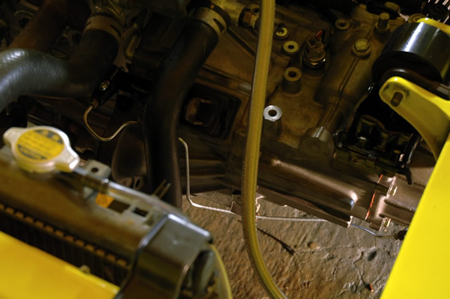

There's my clutch line.

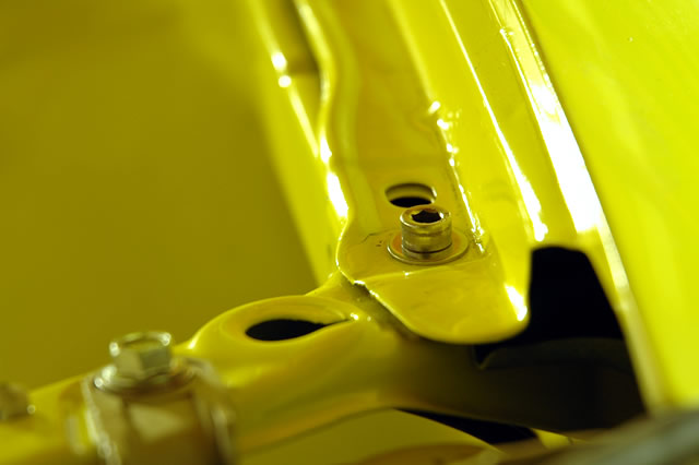

And there's one of those fancy stainless bolts. I used them to mount the fenders to the frame rail.

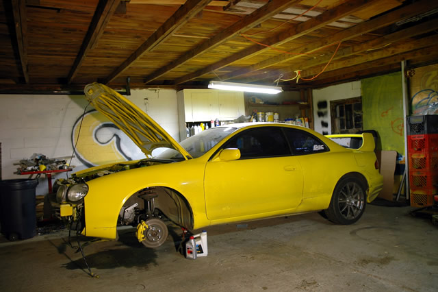

There's the car as it sits right now. Just needs a bumper, sideskirts, extensions, and wheels. Then I just have to add transmission oil, tighten lugs and axle nuts, adjust the TPS, bolt on the velocity stacks, adjust timing, and do a few other minor things and the car should be good to go. smile.gif
