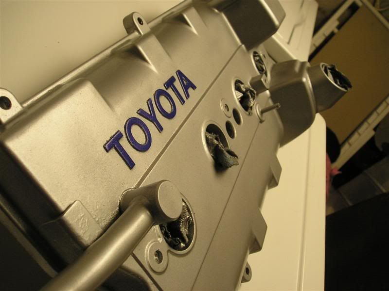

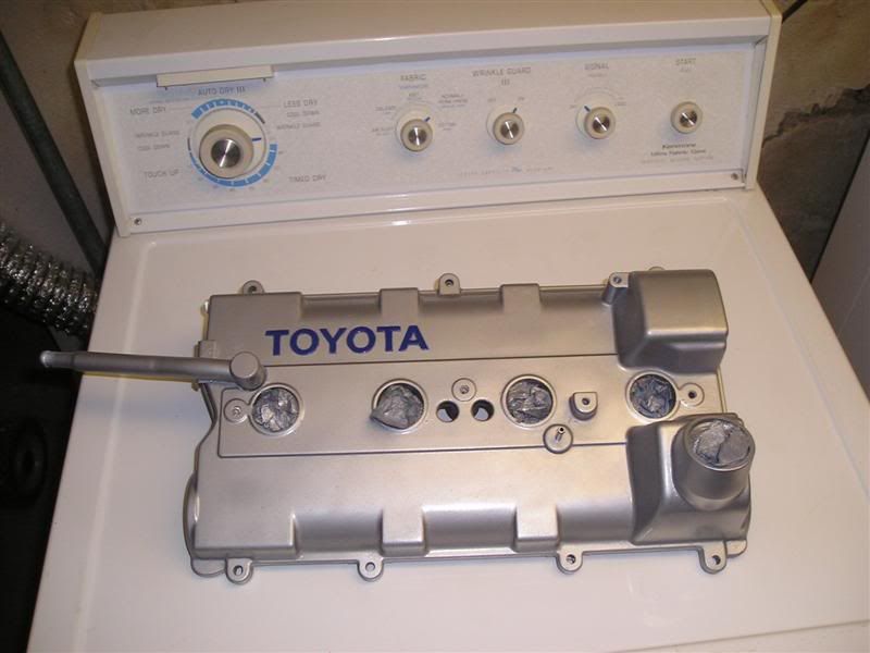

decided to paint my valve cover again, since i had it off and it was pretty dirty. i really wanted to paint it a metalic gold, but it seems like no one sell that color in a high temp paint. anyway, here is how it turned out.

i used a paint stripper on it first. that removed a lot of the old paint i had on there as well as any grease there was. then i cleaned the surface with alcohol. then i did 3 coats of primer... masked off the letting with tape and painted it blue. then 3 coats of paint ..and 3 coats of clear.

i ended up finding the color that i originally wanted. so i had to redo the paint ...again. i think its going to look really good in the engine bay.
