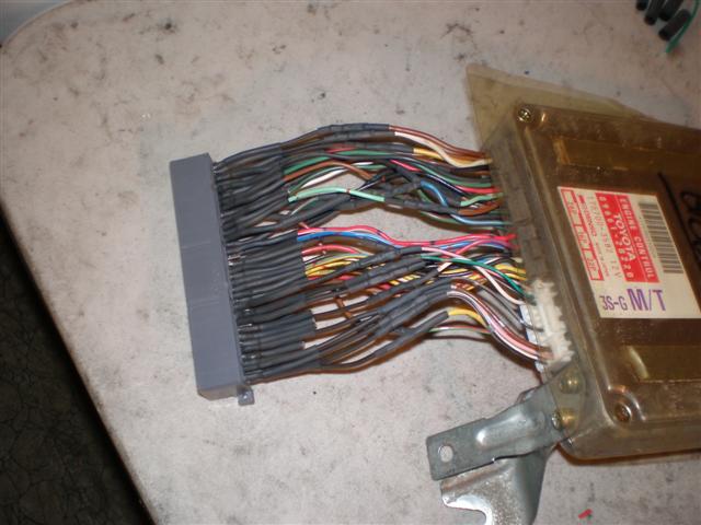

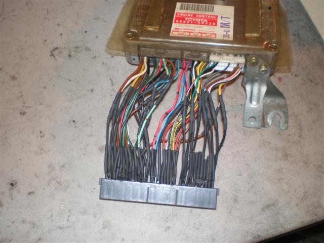

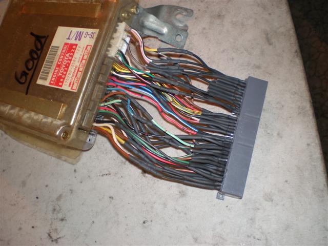

About the same time, I started gathering parts and doing research for making jumper harnesses for various Toyota applications. I located the supplier for the female ECU plugs for a few different Toyota harnesses. When I got one in that matched the 3SGTE harnesses, I though, why not make a jumper harness that goes from a '91 harness to a '93 ECU, or a '93 harness to a '91 ECU? Then customers who run into this situation don't have to find another ECU or repin the whole harness.

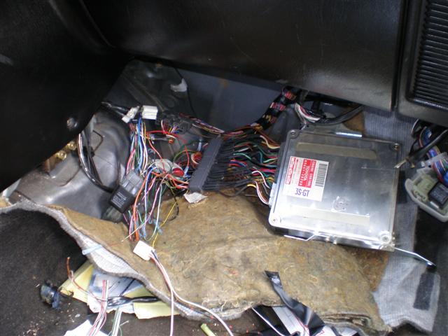

Since I had this customer, Bryant, who had this very situation at hand, and since I happened to be going near where he lived on a recent road trip, I decided to whip up a prototype and give it a try.
There it is plugged into a 3SGE ECU as an example. This first one came out a little rough, the production model will be cleaner.
And here it is plugged into the car:
The jumper harness worked PERFECTLY. It fired up the first try and is running great, no codes and no problems at all smile.gif
