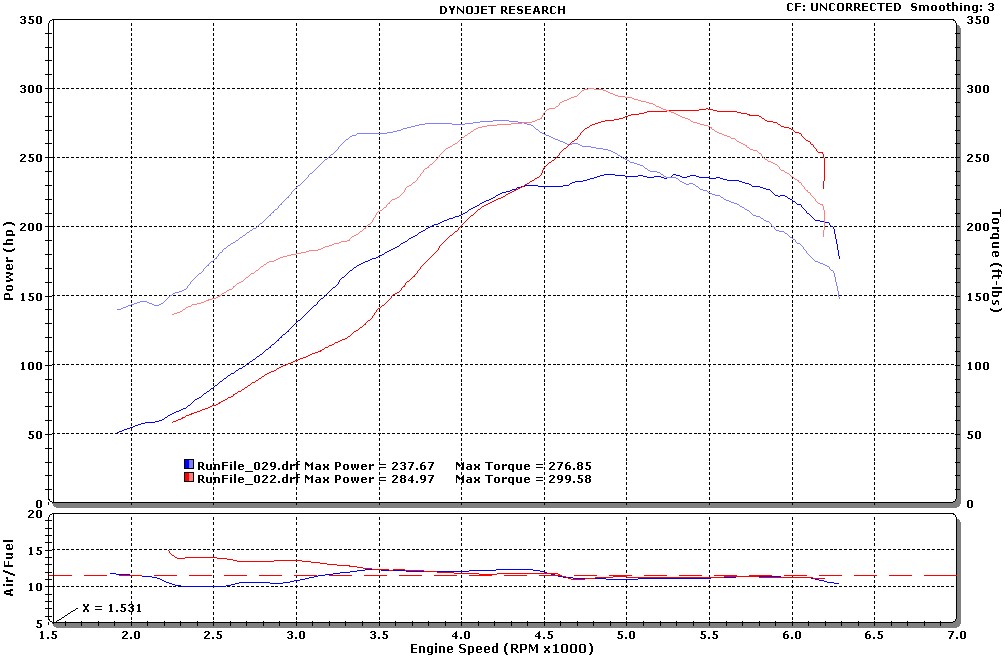

> supershannon77's new 5SFTE powered celica, NEW DYNO RESULTS PG5 285+WHP! PG6 vid added!

- - NaderG   240 HP and 270 Ftlbs of torque .... jeeze! tha...   Sep 29, 2007 - 10:31 PM

- - 99GT   Pump gas? Race gas? What type of dyno?   Sep 30, 2007 - 12:42 PM
- - lagos   what did your safc settings end up looking like?   Sep 30, 2007 - 1:18 PM
|- - presure2   QUOTE(lagos @ Sep 30, 2007 - 2:18 PM...   Sep 30, 2007 - 1:37 PM
- - 99GT   On pump gas.... very impressive. Good work. So w...   Sep 30, 2007 - 1:52 PM

- - 6strngs   so.. 240whp on pump gas vs. your 235whp on race ga...   Oct 4, 2007 - 12:27 AM
- - lagos   QUOTE(6strngs @ Oct 4, 2007 - 1:27 A...   Oct 4, 2007 - 2:07 AM
|- - presure2   QUOTE(lagos @ Oct 4, 2007 - 3:07 AM)...   Oct 4, 2007 - 5:45 AM
- - 99GT   Are you/they plan to run that setup at 11 daily? ...   Oct 4, 2007 - 9:57 AM
|- - presure2   QUOTE(99GT @ Oct 4, 2007 - 10:57 AM)...   Oct 4, 2007 - 11:26 AM
