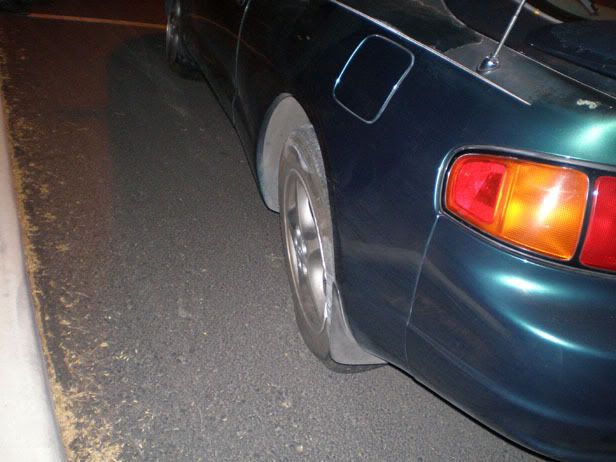

frown.gif i was on my way to school today, and recently it snowed here in jersey, and there is black ice EVERYWHERE, especially in my neighborhood b/c we dont know what SALT is!!! so i knew to go slow, and i was getting a feel for the ice and felt it was very slippery, so as im approaching a corner, there is another guy coming (mind you were still going very slow, 1st gear slow) so to get out of this way, i move over to the right, but as i straighten the wheel out slowly to keep going straight, my car continues to turn, and i slide into the curb!!

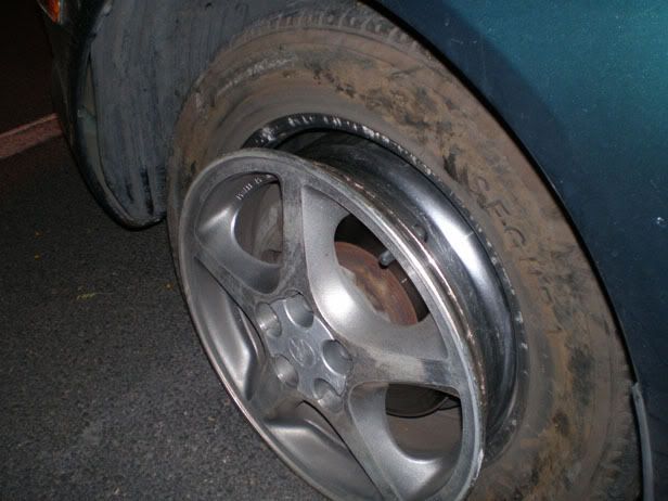

i was saying to myself, aww the rim is prob scratched or something not to bad, but i look at the damage(which ill get pics of ) and the whole rim is dented in, and i knew this wasent good
so i drive the car back to my house slowly, in because of the indentation, the car is going cock-eyed and pushing to the right and the left very hard frown.gif had to take our spare vehicle (wrangler) to school until the celica is fixed....
so i know i need a new rim and tire most likely, i just hope that the rotor isnt dented in so i wouldnt have to get new rotors as well
post Dec 6, 2007 - 9:32 AM
peroxwhysm00
Joined Mar 4, '07
From bayville
my dad looked at it, and said the tire and rim are ok, its just the whole suspension is messed up and takes ALOT of money to fix, i have full insurance, so depending on the cost of damage to fix over the value of the car, i might take the damage money and buy a new car instead frown.gif

Same thing happened to me, but it was rain instead of ice. You'll probably need a new control arm, cambers, spindle, bearing housing, and you'll need to go to a shop to get a realignment.

go to pepboys and for about $200-$300 in parts you can fix it yourself then have it aligned by a shop.
replace the lower control arm, ball joint, tierod end, and have the shop doing the alignment check out your wheel bearing for you. the axle should be ok.
