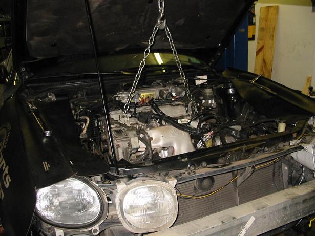

This is a Suzuki Sidekick engine:
http://images.4wdandsportutility.com/featu...Engine_View.jpg
This is a Toyota 7AFE (1.6)
This is a Toyota 5SFE:
This post has been edited by Dr_Tweak: Jan 3, 2008 - 10:06 AM

DOH! That's funny, I just ran a google image search for "5SFE" and came up with that, hit copy and paste, and never actually looked at the engine at all!
Fixed!
