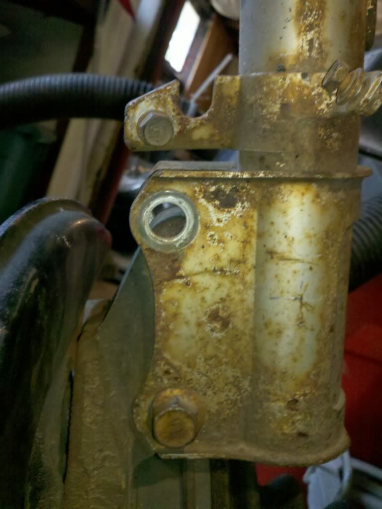

- - playr158   Just left the parts store. Front wheel bearings, ...   Sep 23, 2010 - 10:09 AM
