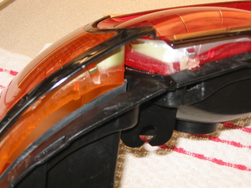

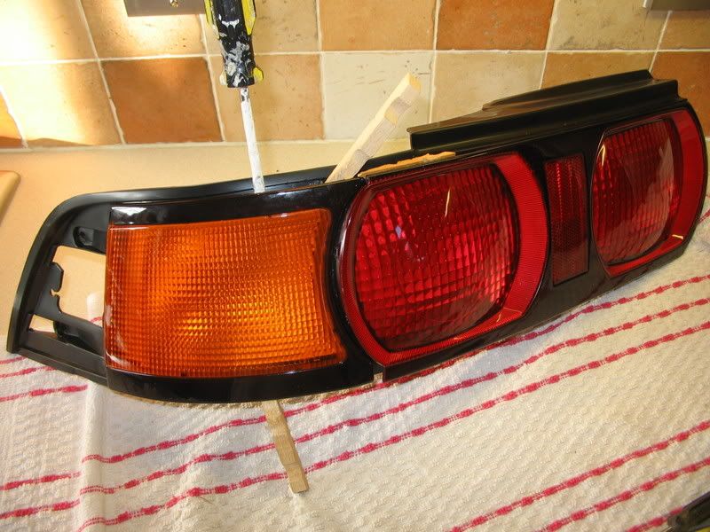

It should be possible to separate the entire lens portion from the backing case by very careful use of the oven treatment. Great care is required.....if the units are not hot enough, you won't shift the lens - too hot and you'll distort/melt the whole thing.
I've used this procedure on Supra mk3's, Corolla/Esprit and all versions of MR2 Mk2 amongst others.
Here's a few pics which might help.....
