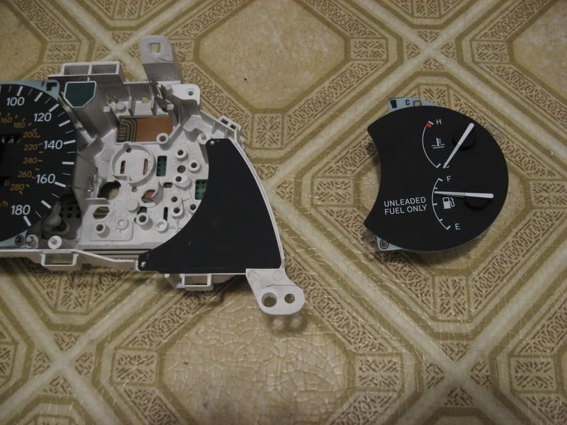

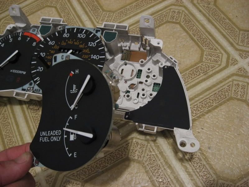

have your cluster out of the car and the 202 cluster side by side flip them over and look at the back. The tach, speedo, and the fuel/temp sections can be swapped and they will work with your cluster. The tach is held on by 3 screws, speedo by 4, and the fuel/temp by 6.
swap the sections, here's a pic of what I mean.
just make sure that the fuel level needle matches your stock cluster.
I can't guarantee that the speedo and rpms will be accurate but obviously looking different is more important than actually knowing your correct speed to you I guess.
