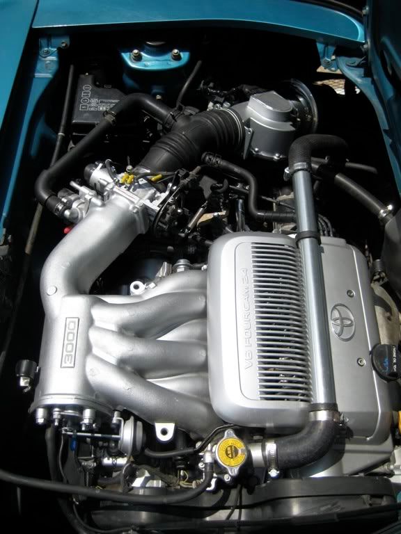

Here is a quick snap of the engine just 5mins ago.
So what do you guys think could be wrong?

EGR assy?

No egr on this motor when i got it. I'm in Ft Worth, TX
