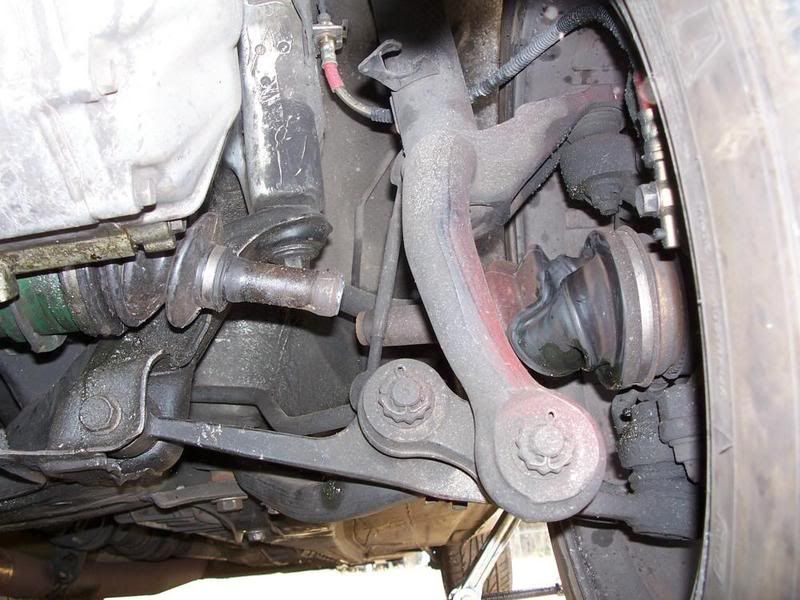

have a look under the car at the front suspension.
after you have slapped yourself and realised yeah you really are looking at the suspension tongue.gif. The fig 8's are the small arms 4" long or so at the front that connect the lower part of the strut to the leading control arm. It will kind of make sence when you see it. Shameless way to add a couple of pics of my own.
This pic is obviously before i installed the kyb super special for street adj shocks, was from a day at the drags where i left with 3wd tongue.gif.

yea wow, how did you snap that...looks like you had alittle too much fun one day, lols....but anywho,thanks for the pic, and i can kinda understand why they are called the figure 8's now...anywho, yea the car is over 108,000 kms, so i guess they would need to be looked at...wow, thats alot of helpful info man..What purpose does your gt4's serve for ya...i mean do you usually get some track time out of them or just a DD to have some fun with?

Snapped it at the drags, launch control (think it was set to 5200 at the time) hot as fnck day, sticky track with much vht down, and shagged shocks (was before the kyb's) plus i believe when i got a dude to replace the cv's shortly after i got it he mixed and matched other celica parts to make one, and clearly wasnt up to the task.
Ive got proper 205 one in there now, and many launches later it still strong as ever.
