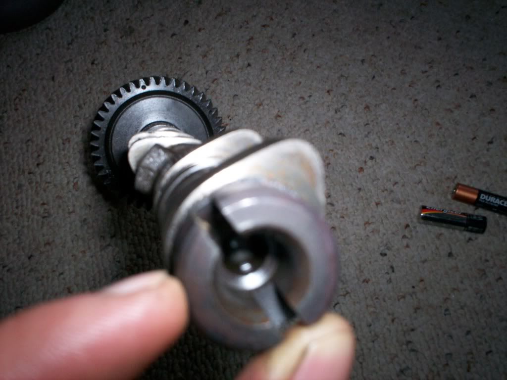

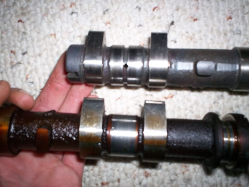

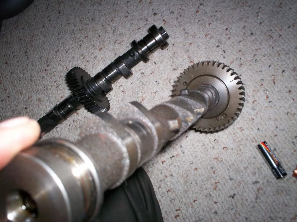

I bought some 5sfe cams from another member, advertised as 294's, so naturally I assumed they were webcams. (looking back, he never actually said who made them) They look funny. The lobes have been ground down so far they are almost even with the bearing surface (does toyota even make shims thick enough for these?) the bearing surfaces are uneven and worn. One cam was hard-welded, the other was just ground down. The lobe profiles don't even look that different from stock cams, except that they are now much smaller overall. Have a look at the pics and tell me what you guys think.
hard-welded ![]() not hard-welded ![]() worn ![]() compared to stock ![]() Are these things even usable??? -------------------- ![]() |

presure2 they look like early (pre 93) cams that have been ... Dec 19, 2008 - 5:38 PM

hurley97 WebCams stamps their name, month and year they wer... Dec 20, 2008 - 6:13 PM

hurley97 They look perfectly fine to me. You're going t... Dec 21, 2008 - 10:23 AM
