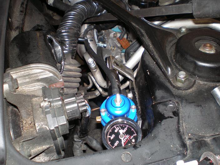

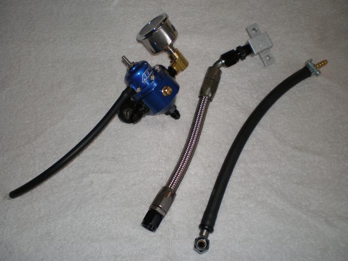

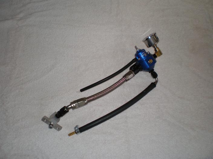

These instructions are for the Phoenix Tuning Fuel Pressure Regulator Kit for the 4th gen 3SGTE engine. This kit includes an AEM adjustable fuel pressure regulator, stainless-steel braided high pressure line, fuel rail adapter fitting, aluminum anodized AN fittings, a fuel pressure gauge, vacuum line and fitting, return line and fitting, and installation hardware. (23 pieces in total!!!) The kit is fully assembled (as shown in the pictures below) and is easy to install. This kit took many hours of testing and perfecting to get it just right, we hope that you enjoy it!
The kit is $379 including free shipping. Everything you see in the pictures is included.

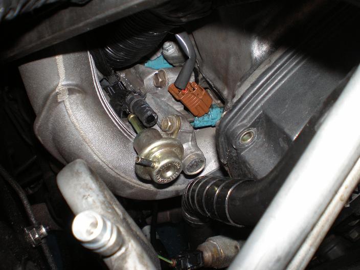

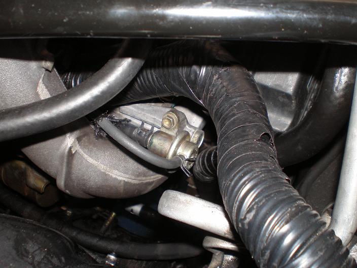

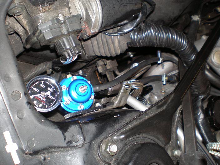

Step 1: Locate the stock fuel pressure regulator located at the end of the fuel rail on the passenger side of the engine bay. Move the clamp holding the return line and disconnect it. (Warning, fuel will come out of the line). Move the clamp holding the vacuum line and disconnect that as well. Then remove the stock regulator by unbolting the two 10mm bolts. The bolts will be reused. After unbolting, the regulator can be pulled out of the fuel rail.

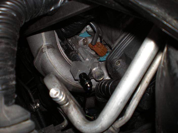

Step 2: Install the fuel rail adapter into the fuel rail. It bolts into the same place as the old regulator, and make sure the AN fitting is facing away from the engine.

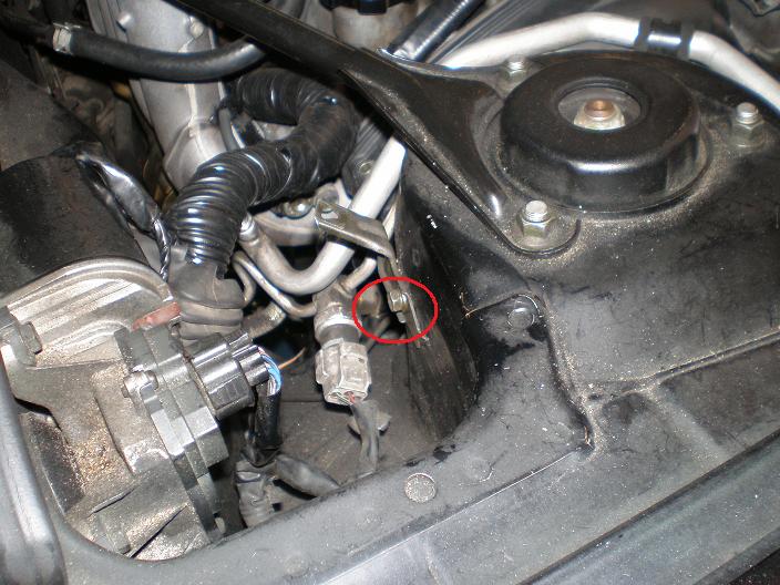

Step 3: Unbolt the bracket shown below, Then bolt the regulator into that location with the included bolt. The bracket can be reinstalled between the regulator and the body if needed. Do not tighten the bolt down all of the way yet. Also, when routing the low pressure return line (which is normally shipped already installed to the regulator), make sure it goes under the a/c lines.
Step 4: Connect the stainless high-pressure line to the fuel rail adapter (45* fitting) and to the new regulator, being sure to route the stainless line so that it is not touching anything else. Tighten the 10mm bolt holding the regulator to the body and then tighten the two fuel line fittings all of the way (the correct wrench size is 11/16"). Connect the low-pressure fuel return line to the return line that went to the old regulator using the provided barb fitting, and move the clamp back into place. Connect the vacuum line to the vacuum line that went to the old regulator, using the provided barb fitting. Double-check that all of the fittings are tight and secure.
