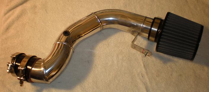

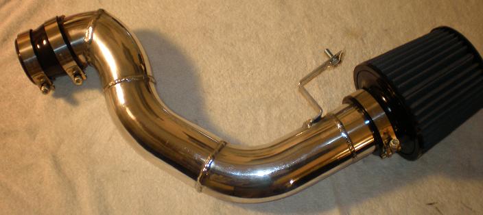

The Phoenix Tuning CAI for the 3rd and 4th gen 3SGTE swap into the 6th gen Celica is now available. The cost is $259 shipped to anywhere in the US:
The CAI kit includes:
Tig-welded, polished aluminum piping
AEM Dryflow Filter
Stainless-steel T-bolt clamps
4-ply Reducer/Coupling to connect to turbo
Bracket and hardware
Air hose fittings for PCV and IACV (optional, not pictured)

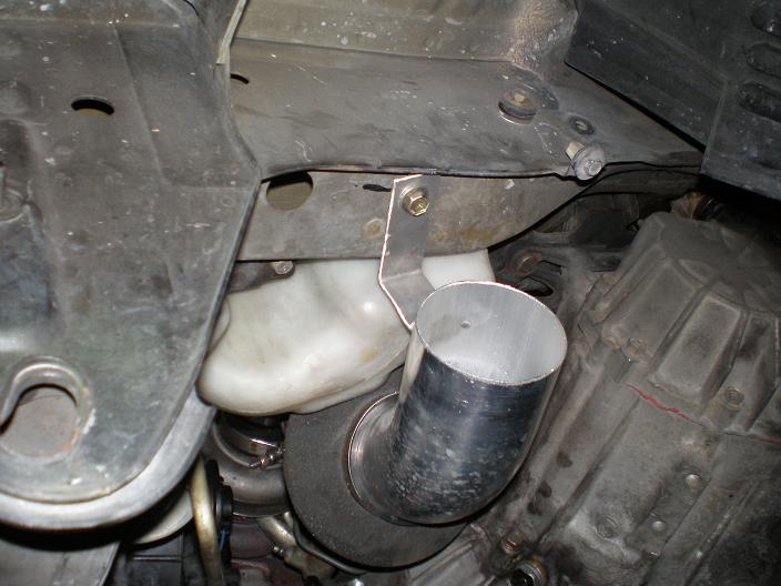

3. Bolt the bracket to the frame rail as shown here:
4. Tighten the two t-bolt clamps at the turbo connection.

I didn't want to post up on your forum just yet. My problem with that is...
boo, that bolts to and is right were the stock st205 IC pump is.
Is there a nipple on it for the 205 oil catch can line ? (like the stock hose has)
also, what size piping is it ?
I guess one would just have to buy the intercooler kit too tongue.gif biggrin.gif
QUOTE (Dr_Tweak @ Jan 26, 2009 - 9:44 PM) *
It is 3" piping.
