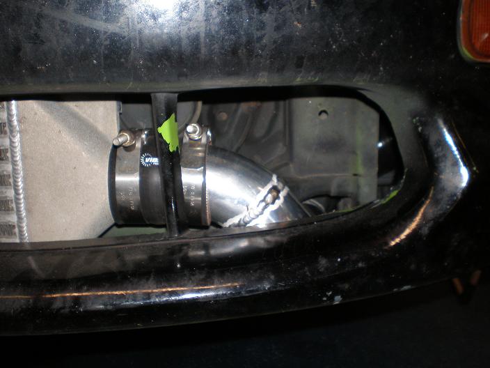

Close-up of tig-welding:

4. To connect the #2 hot pipe, a 3" hold will need to be drilled in the thin sheet-metal between the radiator and the bumper support as shown here. Using a 3" hold saw, use the factory hole shown to center the bit. Before cutting the hole, be certain to un-attach the wiring on the backside of this sheet metal. Also, it's a good idea to put something between the backside of the sheet metal and the a/c lines that are nearby, to prevent you from nicking the a/c line should you suddenly break through with the hold saw.
5. Then connect the #2 hot pipe. Put the two t-bolt clamps in place for the coupling from the pipe to the intercooler, but do not tighten them.

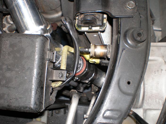

6. Install the 2" hump hose connecting the #2 and #1 hot pipes, and install the #1 hot pipe from the turbo to the #2 hot pipe. Put all of the clamps into place, but do not tighten them yet.
Try to make sure that the piping is not making contact with any parts of the body or engine. Once all of the piping, couplings, and clamps on the hot side have been installed and positioned to your liking, you may tighten down all of the t-bolt clamps.

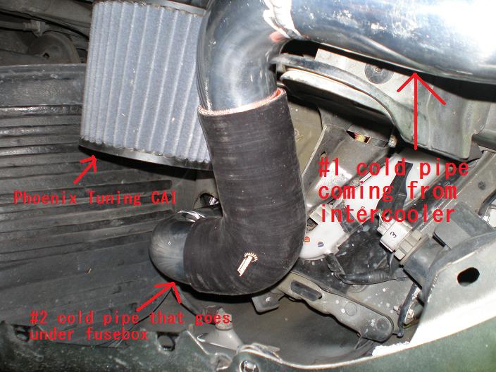

7. Install the #1 cold pipe. Again, put the clamps into place but do not tighten them all of the way yet.

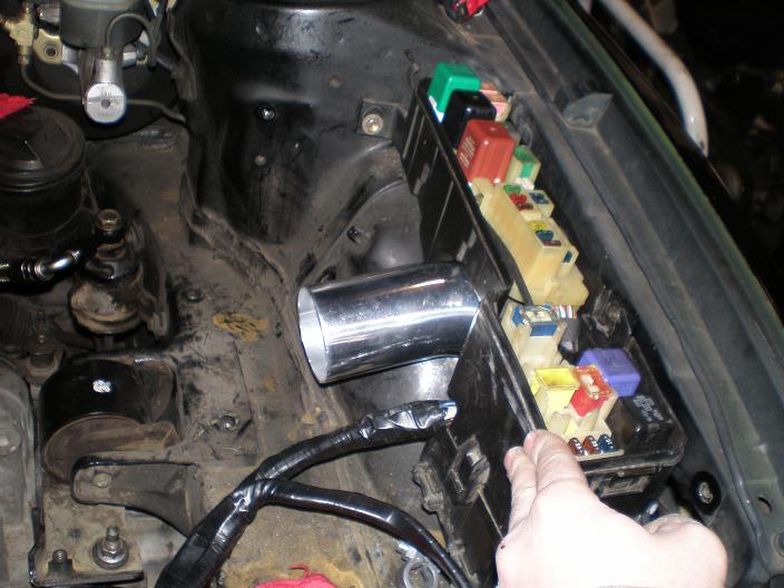

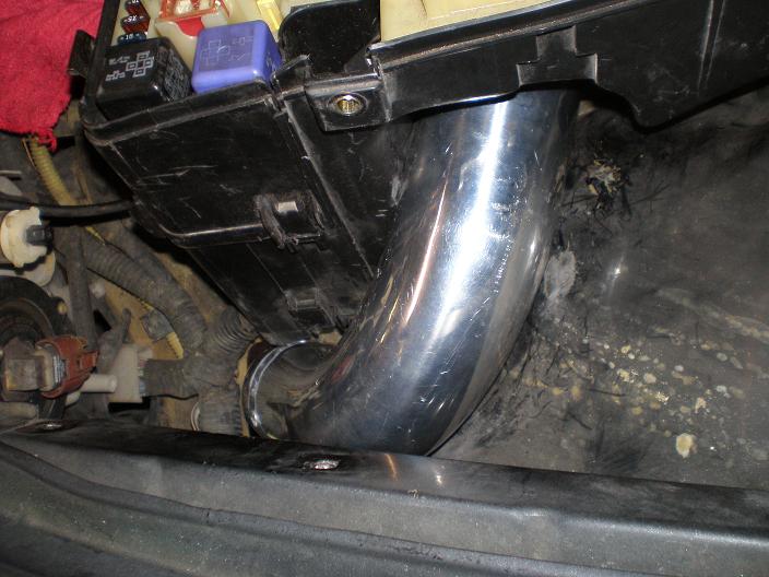

8. Install the #2 cold pipe, which goes under the engine bay fusebox. To do this, you will have to first remove the THREE 10mm bolts holding the fusebox to the chassis, and move the fusebox to the side. Also, if your factory air box silencer has not been removed, this will have to be done at this time. Connect the #2 cold pipe to the #1 cold pipe using the 90-degree coupling (for version WITH fog lights).
Bolt the fusebox back into place.

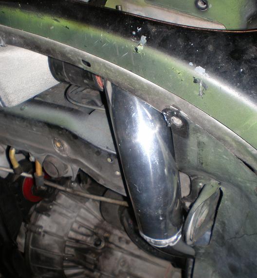

9. Install the final piece, the #3 cold pipe:
Once all the piping, couplings, and clamps are installed, double-check the positioning of all of the pipes to avoid contact with the frame or other parts. Once you are satisfied, tighten down all of the t-bolt clamps. Also install the BOV. Double-check all of the connections to be sure they are secure. Then enjoy!
