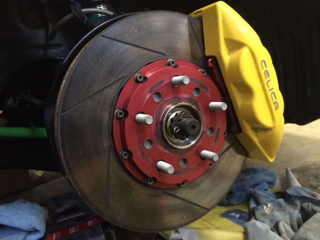

back to the car this weekend and got a little done. Most was planning/measuring for a few things.
got the 5x114.3 hubs in and mounted
while cleaning the passenger side caliper I found some pitting in the powder coat. The same showed up on the drivers side caliper in the same spot.
I had planned on mounting the front wheels today but my tie rod end on the drivers side decided to be an ass and freeze up on me so I will have to wait until my new one comes in. At that point the Spacer Adapters from MotorsportTech will be in so I can mount all 4 wheels at the same time.

What pads are you running? Possibly the cause of pitting?

Red stuff pads. I think its due to the heating of the calipers and possibly bad bonding of the coating

QUOTE (Tigawoods @ Feb 13, 2016 - 6:59 PM) *
Looks as though its just behind the face of the caliper. Hopefully it wont proceed to being worse wink.gif

Should measure the offset on that rotor har

QUOTE (4-eyed-freek @ Feb 13, 2016 - 8:18 PM) *
If it does, thatll just be an excuse to get AP Racing Calipers!
QUOTE (njccmd2002 @ Feb 14, 2016 - 8:09 PM) *
Should measure the offset on that rotor hat
I should shouldnt I kindasad.gif ugh
I am going to need to start to prepare for an inevitable new rotor purchase for myself soon anyways
