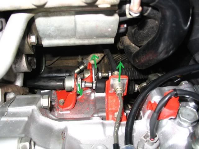

What you do is push the linkage through the bracket's loop until that groove comes out the other end... then just put the "U" shaped clip into that groove to keep the linkage from sliding back out again.
Here is the best picture i could find. the top of the "U" clip is facing the camera. But... Look at the Clutch line, and you can see how it is also held by a "U" clip in the same manner, only its smaller...
hope this helps
