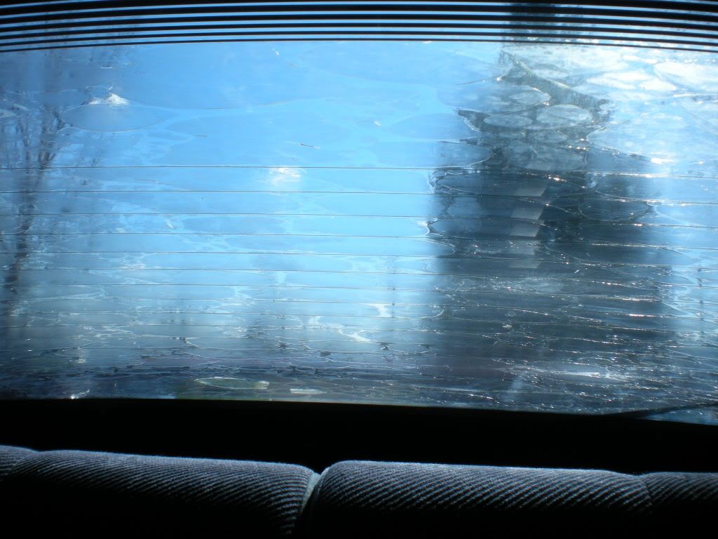

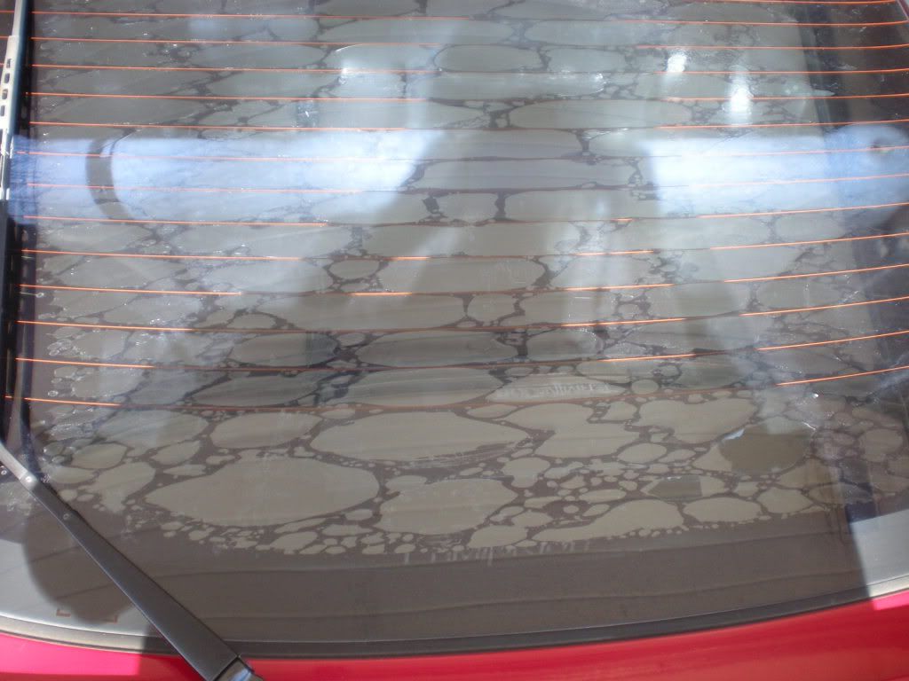

what is the best way to remove window tint besides using a razor blade? i know thats probably the most effective but im afraid ill damage the rear defrost and be screwed, so im wondering if there is a better way to remove it.
this is what my tint looks like now, so as you can see its a driving hazard, i dont use mirrors!
inside looking back
outside looking in
it looks so ugly!

I have heard that ammonia liberally sprayed on the film and leaving the car to sit in the sun can help it peel off.
However, sometimes, its just so far messed up that it's impossible to get it to peel off all at once, and the using the razor blade is inevitable.
Even if you take it to a respectable shop, sometimes the blade is the only choice.... kindasad.gif

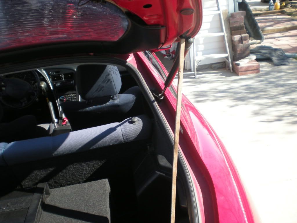

im thinking im just going to remove the window and set it in the grass with ammonia and just go to town, because i my truck lifts are shot.... i use a stick to hold my liftback up

lol i was using a stick too i just replaced my hatch shocks.

Yes, use ammonia, and then tape a black garbage bag around it and allow it to "bake" in the sun. A razor blade will damage the rear defrosters like you said, so just use the ammonia and you should be good to go.

When I had my tint removed the guy that did it just got a heat gun...the type used to burn paint from window frames etc...looks like a hair dryer...he heated the film up and then just peeled it off...it came off in one go...you just have to be carefull not to heat the glass up so that it cracks......once the film was removed the window was washed with window cleaner and it was done....took less than 5 mins.

It's not that simple. Tint is NOT a big sticker. It has to be glued on. If he tries to peel it off, it will simply rip then he'll be missing a corner and still have 3/4 of the tint stuck to his window. And where he manages to get the tint off, he'll still have glue stuck to the window. That's why he has to soak it in ammonia or scrape it with a razor blade.
