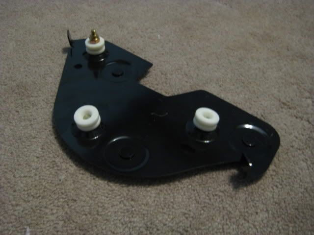

> Guess what i just got today!, you verty guys will love this.

Im gonna make a DIY this weekend with this part muahahha

lol...that looks nice for whatever its for...i dont own a vert so i wouldnt know, but what is it?

It's for the quarter window.

QUOTE (96bluevert @ Apr 22, 2009 - 6:08 PM) *
Just came in today, was order from 1sttoyotaparts PART NUMBER #69082-0W010
I paid a total of 78 CAN, which is really cheap compared to my local dealership with workers discount = 250 CAN mad.gif
Yeah, well I know MaskedMan made a DIY for how to replace this part. Well, Im going to make one too, this is probably the only time you can say too much information can't hurt you biggrin.gif hoping the weekend is going to be sunny!

whats it do?? hold the window?

95celgt - Your quarter window is attached to this piece, which is than sort of attaches to track guide. This is how your windows slides up and down well with the help of the motor pulling it of course.
njccmd2002 - It was thanks to your guide that I even had any hope of trying. Yup I did, going to do the other side but I ran into a electric problem. I fried my entire quarter window electric wiring... so im trying to figure out how to fix it right now its really weird because there are no blown fuses. (haven't found "power main relay" yet to test if that's the culprit. but yeah, too remove that really odd bolt/hold thing I used a 9/16 wrench with a screwdriver. I have pics I'll make the DIY once my i figure out how to fix the electric problem. I'm hoping its just a relay cause i really don't want to rewire the entire system.

so you guys are having problems with this quarter window bracket? ive just never seen it go bad lol

QUOTE (95celgt @ Apr 28, 2009 - 9:46 AM) *
Well what happens is (because our cars are kinda old) the lube they used 15 years ago on the tracks has attracted a lot of dirt and debris. Than as the rollers roll up and down with the tracks, they get stuck.. and like mine the roller broke. (had it on automatic down) but yeah you can't buy those roller things by them self you have to replace the entire plate.
