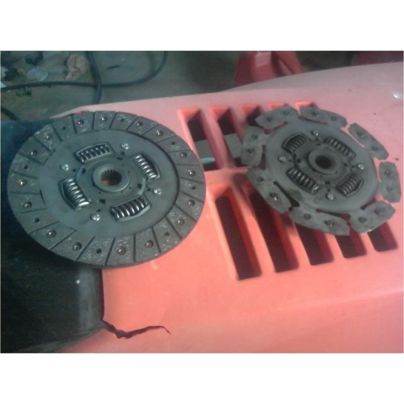

Well mine is done. I'm 16 years old and i've never even pulled a engine or anything more than changing front brakes before, and I did it. It's tricky, you just may need a few extra hands. I couldn't take any pics other than what you see of the clutch I raped in 5 seconds flat.
I still own my celica, but i'm parting it out and junking it.. Or selling as a whole. Have a honda prelude now :(
post May 31, 2009 - 7:22 AM
wow. that clutch on the right looks just sliiiggghhtttly worn.
lmao.
what brand is the replacement?
good job on getting it done man, the first time is always the hardest. things get much easier after those first few projects.
trust me, after doing a handfull of clutch jobs, i can remove and reinstall a tranny (in a 100% stock car) in 2.5hrs. hehe
post May 31, 2009 - 12:02 PM
Superaison
Joined Apr 25, '09
From Ohio, USA
lol thanks dude.
Idk if I explained how it happened, but long story short, on a hill/incline ( a crazy one ), from a stand still trying to go forwards, I put it in 3rd on accident and gunned it because I didnt want to run into a sign behind me from rolling back, well, i still rolled back lol. there is so much clutch dust or w.e in random places on me, and in my garage. When I pulled out the starter, I got clutch disc dust WHATEVER the name is, all over the ground and **** lol
