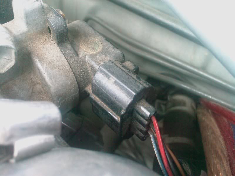

My check engine light came on yesterday. I reset it today during work and it came right back on.
I checked under the hood and found:
Here is where it is in the engine bay:
Can someone help me figure out how to fix this? I don't see a way to pull the connector apart to re-solder.
Right now all I can think to do is try to get another connector and just splice in my wires. I def don't want to go to the dealer.. and usually our junk yards don't have 6gc's...
Anyone here have one I could get ASAP?
Thanks!

ahhh the throttle position sensor, the connector does come apart... off the top of my head... i think you just put a pin in the front and lift the tab and push the receiver out the back

should be the same clip on a camry?
post Jun 21, 2009 - 11:02 AM
pitt nailed it on the head.
you can get one from a junk yard and wire it in, or PM dr tweak, he can get the connector itself for ya if you want to buy it new.
