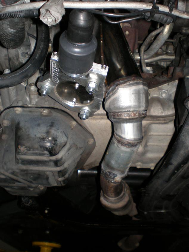

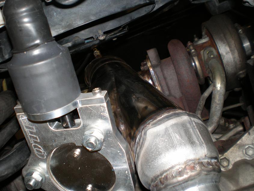

Prodigy515 picked up this 3" electric cutout and this past weekend I put together a downpipe for him and welded the cutout in. The upper part didn't quite come out how I wanted but I've got some ideas to make the next one better. Making the transition from an irregularly shaped oval to a 3" round pipe wasn't so easy smile.gif Anyway enjoy the pics, we're going to get a decent video camera one of these days and take a vid for you.

post Jun 23, 2009 - 1:48 PM
you should have gore cut several sections of pipe together to make that trasition smoother, the way it is is horrible for flow.
props for making a downpipe tho!

good job on the downpipe. I've been drawing up pipe for the past 2 weeks at work. I don't think you could effectively add a gore to the pipe while keeping the O2 sensor there. Maybe if you just move it down to just before the Y you could smooth out that elbow.

QUOTE (presure2 @ Jun 23, 2009 - 2:48 PM) *
Yeah not real happy about how that came out. What makes it difficult (that you can't see in the pic) is that the pieces in that bend are going from a 4" irregular oval shape to a 3" round pipe (if you look closely at the pipe closest to the turbo you can see it's ovaled out) so making a smooth transition while doing that was a pain. Interestingly though when you look INTO the downpipe through the flange it looks much more smooth of a a bend than from the outside.

Isn't that cutout's exit properly positioned to cook the oil pretty effectively?
