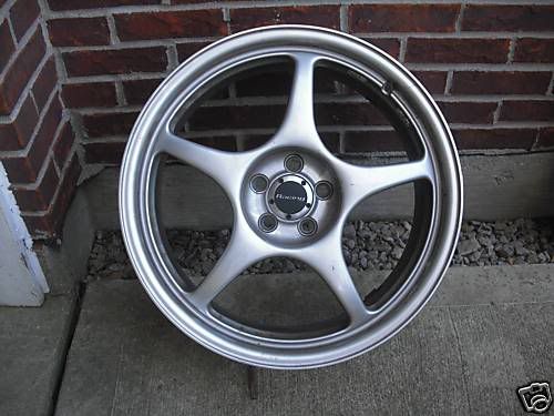

I am liking these rims and wonder if they would fit. There wrx rims 5 by 100 like a celica and the offset is 48 does anyone think I will have problems fitting these rims? I read online others putting wrx rims on a celica let me know asap they end soon

you will need spacers ( I'd recommed 10 MM ) and they'll fit / look perfect.
