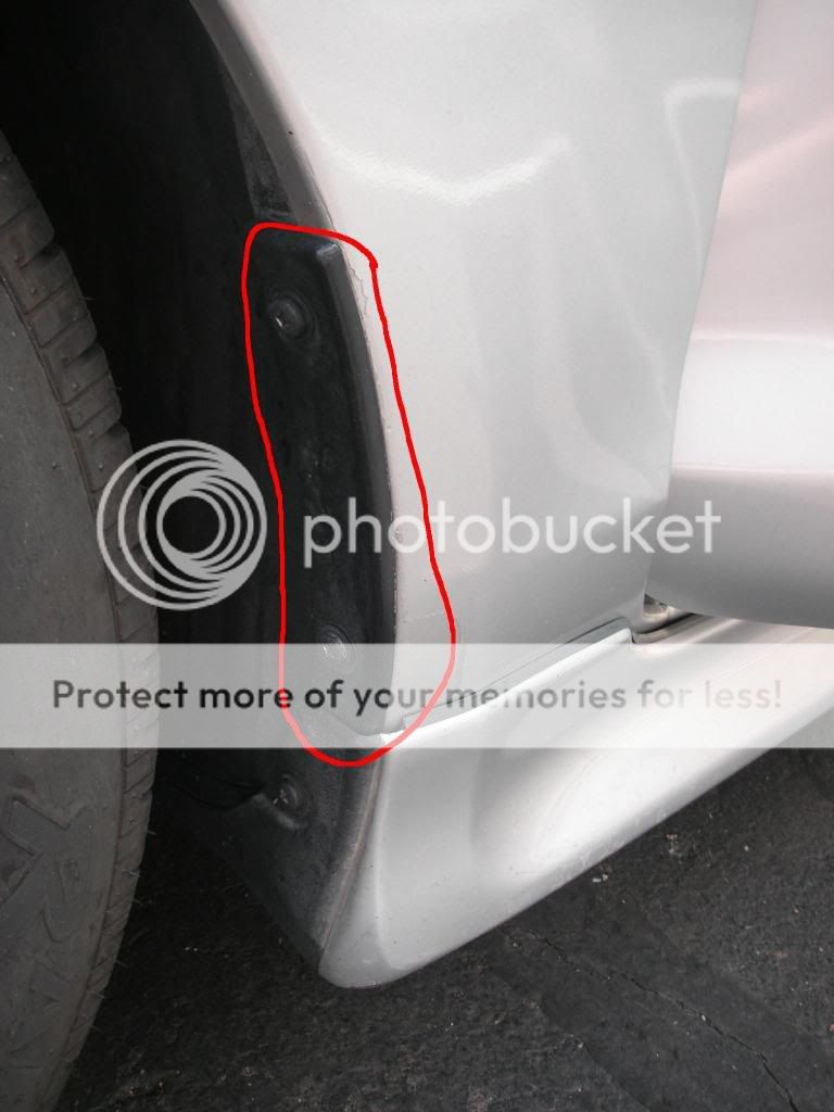

do you need this rubber thingy to install them??
i mean my rear looks like this..
coz i cant seem to align them properly.. if i bolt the side two screws.. i cant bolt the bottom screw.. if i bolt the bottom screw.. i cant bolt the 2 screws on the side.. they dont seem to fit very well but they're not replicas.. they're plastic.. frown.gif frown.gif frown.gif frown.gif frown.gif
where does this hole go to?? (1st hole from the right) it doesnt seem to fit anywhere.. unless you drill hole on your bumper.. frown.gif frown.gif frown.gif frown.gif frown.gif
thanks..

QUOTE (shegarhuney @ Aug 25, 2009 - 1:28 PM) *
I just used a regular self tapping screw to stock bumper here to do the final fitment. this should be the last screw you put in.
As for the rest I'd screw in the bottom screws first and if you need a spacer between the splitter and the fender for the last two side holes then I guess you know what peice you need there. You could also very easily make that spacer out of almost any old thick plastic you have laying around and paint it when it's all fitted.
Mine don't have that spacer but mine are replica rears also

Mine has that plastic piece that would go between the splitter and the fender, and fitment on both sets of rear splitters I've had has been painless. So as Death advised, you might want to make some spacers. As far as that last hole, self tapping screws work great. I personally chose to drill a small hole and use some small screws that nobody would ever see, but I would have gone with some discreet self tapping screws if I had any sitting around.
