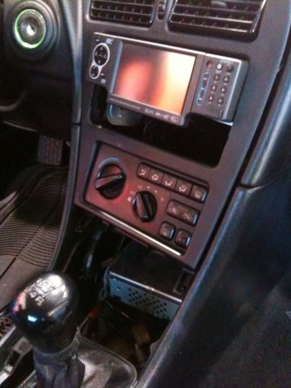

Ok guys, I have some updates. First off, I'd like to thank Aerl, Kyle and Ben for their help with my speakers. If it wasn't for them, I wouldn't have my Apline speakers in.
Now.. I have one simple rule.
ALWAYS BELIEVE RUDE BEST BUY EMPLOYEES...but don't pay their prices.
Long story short, we weren't able to get the new head stereo unit in because we didn't have the appropriate wiring harness. We bought two, and each seemed wrong. One fit the stereo but plugged into an amp which we thought didn't exist, and the other had the ends we thought we needed but didn't fit the stereo.
So today, I decide to look at the car with fresh eyes. I take off the trim and look at what we thought was the ECU yesterday, and realized the only batch of wires coming in OR out was the very wiring harness we were looking for. Yes.... this was an amp. READING ALSO HELPS! haha. The ECU can be spotted about 2 feet deeper in the car's dash.
SO, I got the wire I once bought after returning another I had bought, and started hooking up the new stereo. Here is my progress at that point. The stereo works:

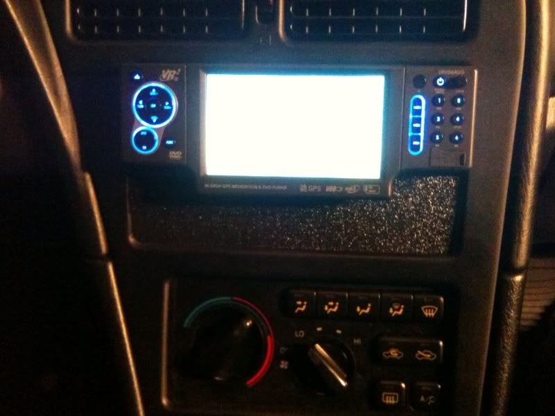

Now, I have a deeper problem. The trim still doesn't fit. I use a dremel and a drum sanding bit and make the hole a bit larger and make the rounded corners in the top area more angular to fit the new head unit. I put velcro on the underside and topside of the stereo to block out any dash LED light that could come through, and test fitted it. It still didn't go through. After looking at it over and over, I realized that these little tabs on the side of the head unit were catching on the trim. I dremeled these off, and walla, it fit! I put the trim back on the car and everything fit. I took a piece of spare black ABS plastic that I had from a previous costume in a volunteer group I'm apart of (the 501st) and trimmed it to fit the hole under the head unit. It's now glued to the back of the trim. I did this because the old bin didn't fit.
I took the stereo back out, and fit the GPS antenna in the car near the top of the dash for the best signal. It's not strong enough to work from under a garage, but once you pull out, it works... which is awesome biggrin.gif. Free GPS! Woot!
The DVD player function works as does the radio.... now for the auxiliary wire for the iPhone/iPod support. My kit came with two chords and I tried the first. I soon realized that I only got sound on the left side of my car. I looked at the other chord and saw it had two ridges (for stereo).. and the one coming out of my car... had one (mono sound).
Sigh.....

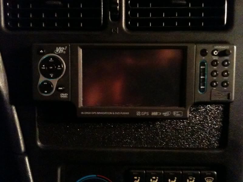

I took off the trim .. again.. and put the new chord in. I re-taped the excess chord together with electrical tape and put the trim back on. NOW everything works, with stereo sound biggrin.gif. Btw, in case you didn't see what I did, the auxiliary chord is coming from the stereo through the little storage bin in the dash. I drilled the hole in the top of the holder so the wire wouldn't want to fall out and so you couldn't see light come in from the LEDs behind the dash. I rewired everything and turned the car on... smoke started coming from the dash.. but not the stereo (whew!). It was fortunately only the cigarette lighter. It seemed the filament shifted and started burning against the side of the lighter wall. I threw this away, counted my blessings, and put the trim back on with everything functional now smile.gif.
I'm left with this!:
