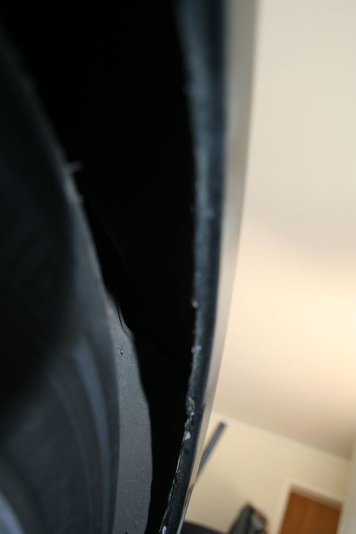

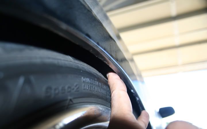

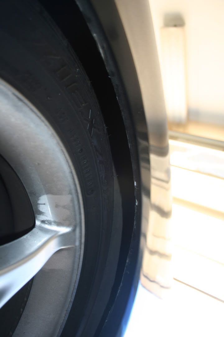

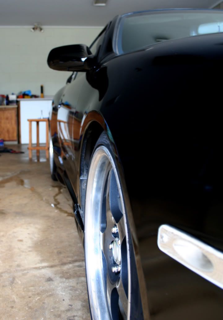

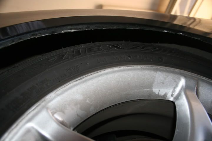

I didnt wanna pay $60 per fender and some guy to molest and touch my car. so i sat down with the die grinder, welding mask, and a beach towel and started cutting my fenders.
My weapon
The leftovers
Passenger side
Driver's side
10mins each fender.
Procedure:
-Lift rear end
-Take off wheels
-Scrape inside fender lip to get rid of the dirt and what evers behind there
-Lightly graze the fender lip with the die grinder to make a guide line
-Cut deeper in the line (I made 6 passes to make sure i had a good clean cut)
-When satisfied with the clearance put wheels back on and call it a day.
Used the welder helmet so i dont burn myself cuz those sparks get really really hot.
Then I used a wood block and a hammer to lightly roll the fresh cut area so it looks cleaner and to protect from anyone getting cut. Gonna sand and touch up paint the area later whenever i feel like working on the car again laugh.gif So it doesnt start to rust and rot away thumbsup.gif
This post has been edited by 808celica: Oct 17, 2009 - 7:58 PM

QUOTE (808celica @ Oct 15, 2009 - 6:40 PM) *
At first I thought this was going to be a question of which to go. But apparently not. laugh.gif
Yes, you need to grind down that edge. I have heard of people running flushed up wheels slicing their sidewall. Hence, why most people choose to just roll the fender. I have heard of people complaining that cutting the lip weakened the fender. Since it did not have the arch to support the fender it can collapse easier. (This is more of a drifting issue though.)
Good job on the cut though. Looks pretty clean.

Yea this would be the incorrect way to go about that. You should have gotten a fender roller and a heat gun and done it the proper way. Cutting is an extreme resort to this needed solution. But either way you got the job done and if you are happy with it thats awesome thumbsup.gif
I would suggest getting some black paint on that cut edge though to cover up any bare metal left over

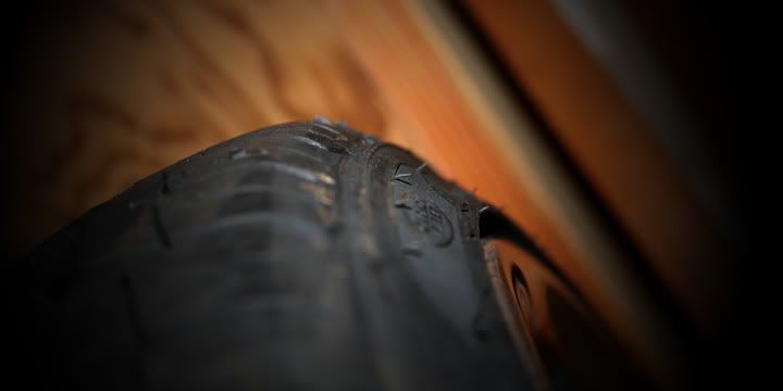

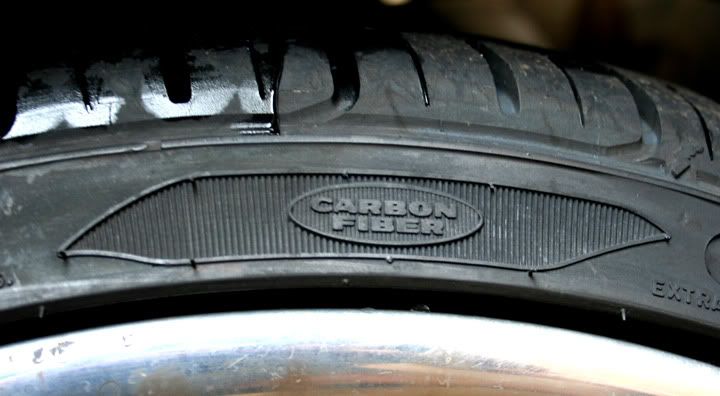

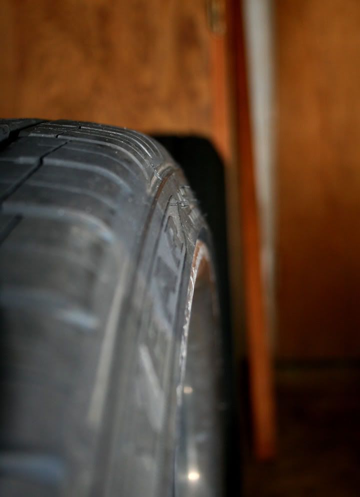

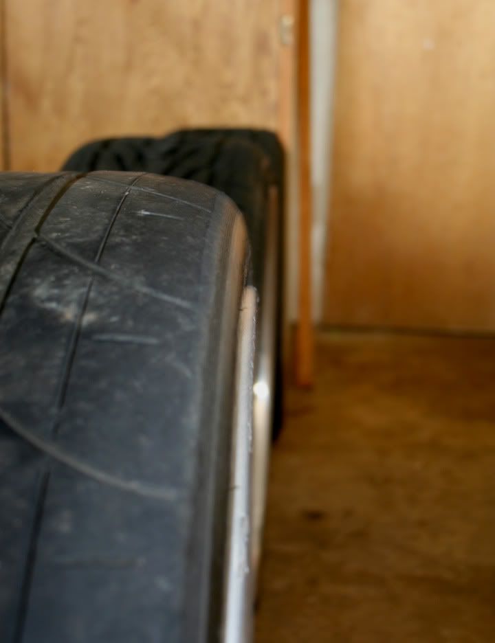

225/35/18 Yoko Parada Spec 2 (if i had a choice i'd wanted to stick with these but in 215/40/18)
215/35/18 Goodyear Eagle F1 All season (Tires SUCK!! but $220 for both mounted and balanced wink.gif who could resist) Healthy stretched
kinda giggling when i saw this
if i had a choice on tires up front i would've had Yoko Parada Spec 2 215/40/18 all around (dunno if they make this size). 205/40/18 Dizzeras if they had in stock that day kindasad.gif
+ cambered the rear, too lazy to + camber the front, raised the car cuz ^^^bumper is hash. 5mm spacers in my tool box, too lazy to add them on.
The leftovers
OMG!! I couldn't bring myself to do that to my car, plus cutting anything like that on and car in new england leads to bad bad things I don't even want to imagine.
I couldn't get a fender roller so I ended up buying a cheap heat gun and making Dustin ghetto roll my fenders because I couldn't even bear the thought of swinging a hammer near my car, at least if it was Dustin that messed it up I could just blame it on him. biggrin.gif
Did that completely solve you're rubbing issues? Mine was pretty bad before modifying the fenders, now its ok for me but I can't have any passengers in the car or it still rubs sometimes.
