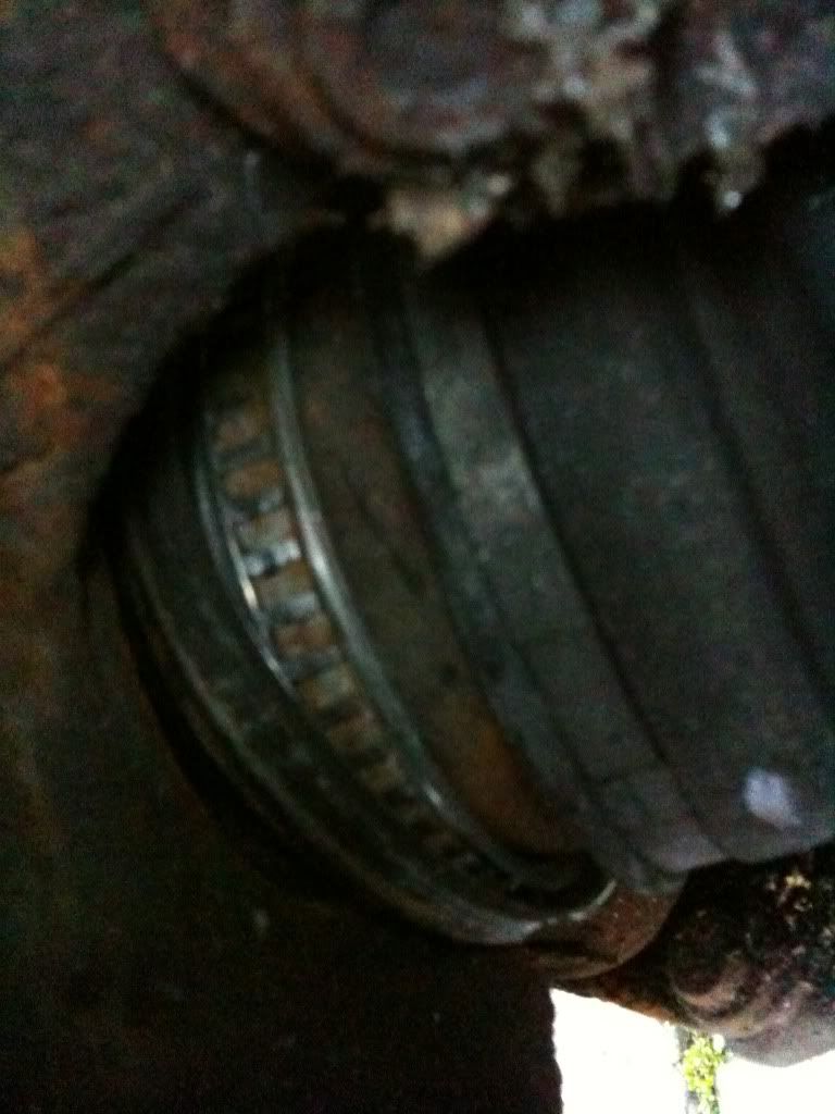

On the way to my gf's last night and the ABS light came on followed very quickly by some serious grinding noises from the front passenger side. I checked it looks like cv joint has gone as there is a watery grey grease all over the place round the wheel arch. My brakes seem to working at about 20% so im guessing the abs has failed aswel due to the sensor moving?

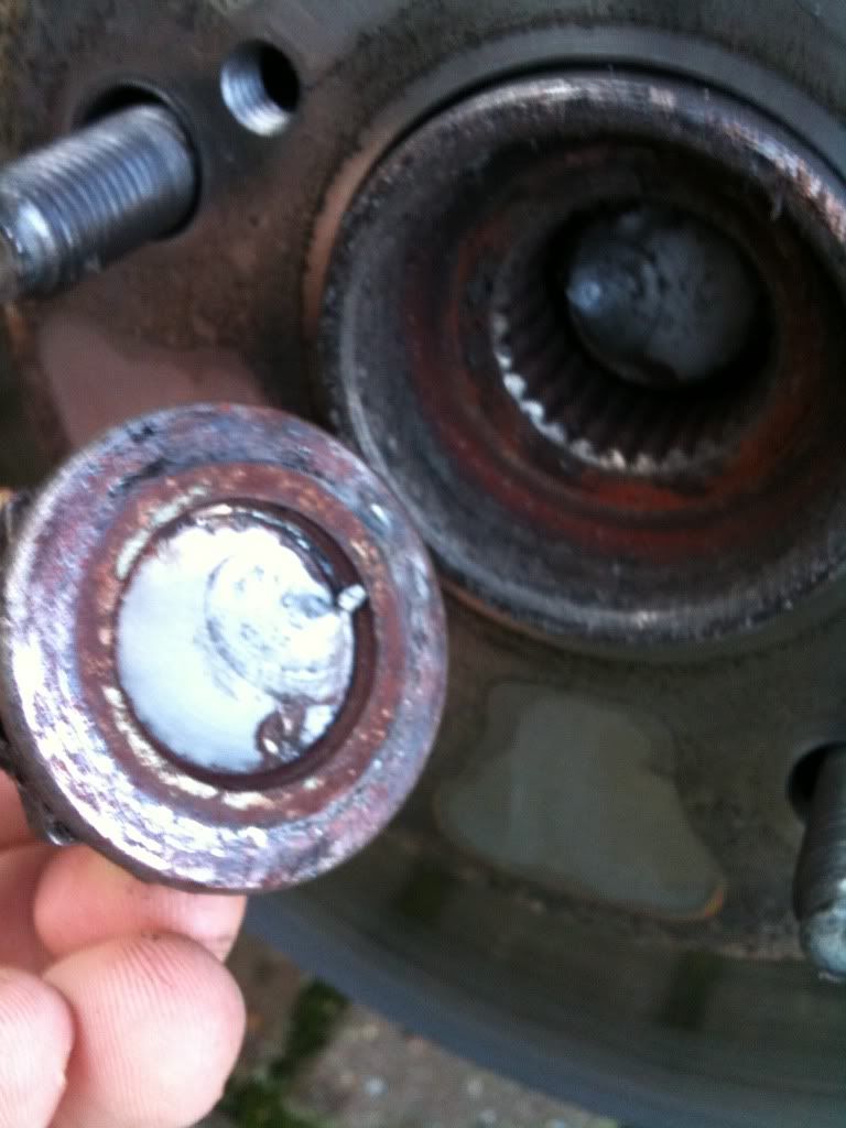

I took the wheel off to have a look yesterday, does'nt look good at all. Took a few snaps to show the damage!
Basically the Driveshaft nut has sheared off completed. The abs doesnt work and the CV Gaitor is split. I imagine this is due to the wheel bearing failing. I had it replaced about 4months ago and i wasnt happy with it afterwards. So im thinking he either fitted it badly, he over tightend it or it just broke?

haha i did the same thing to mine, however, it was caused by torque spin... split it right about where you did... replaced the halfshaft and all was good.

yeah i think the bearing failed because the hub nut was over tightend....should be a fairly easy fix and all for £170!
