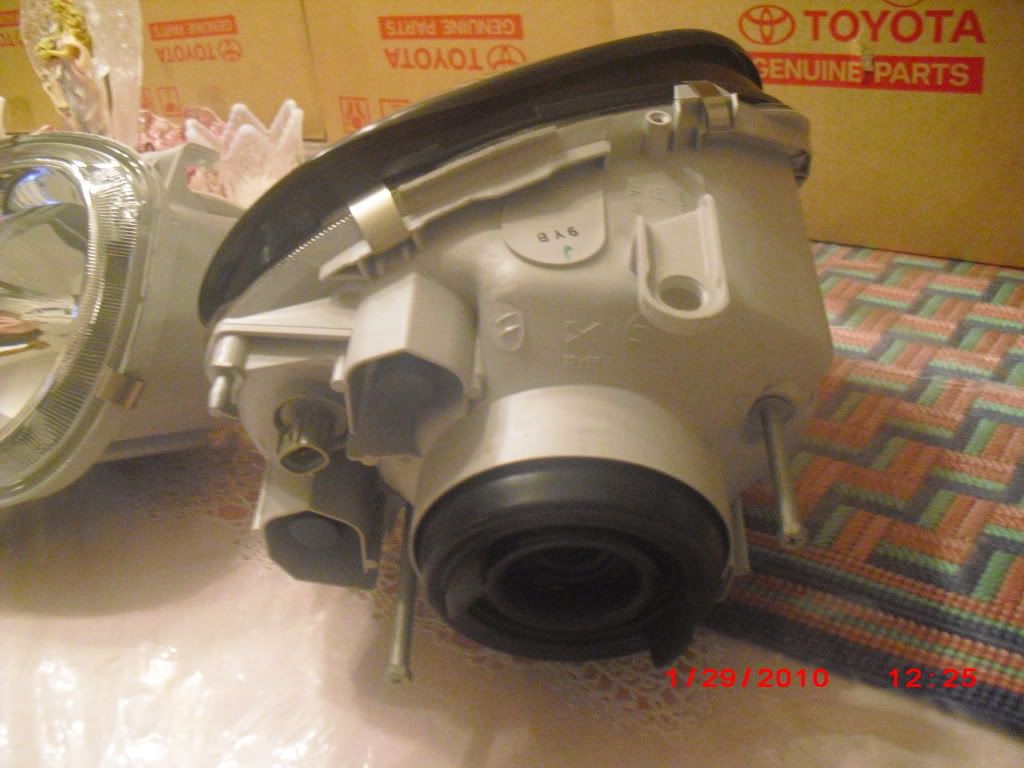

I received my set of JDM headlights earlier than expected today (Ordered Dec 20th with an expected back order of 6-8 weeks) so I'm quite excited

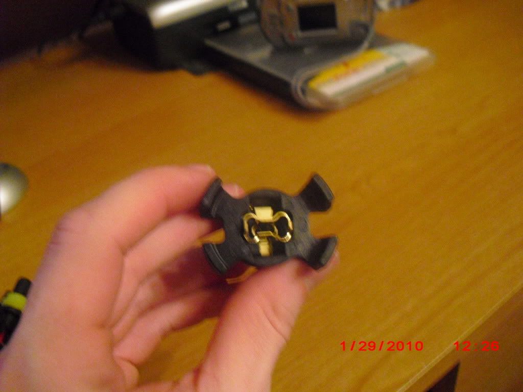

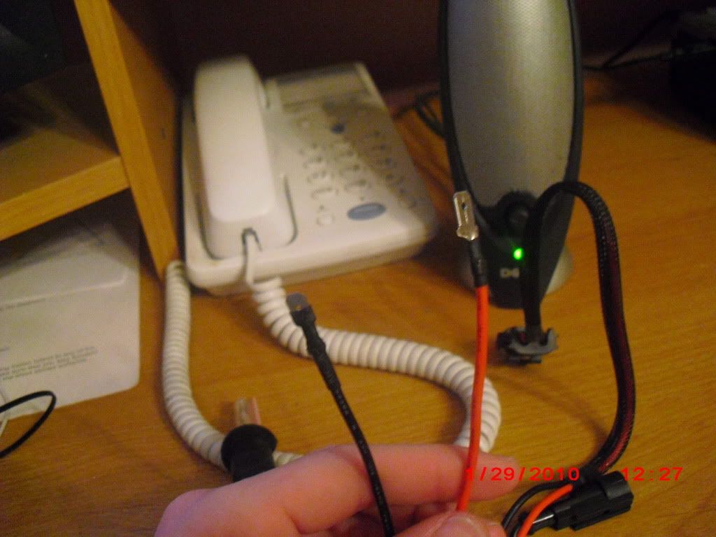

![]() Also, the high beams I know are 9005 just like the usdm ones, but my H1 HID bulbs (the real reason I got the projectors) don't seem to be a direct fit? I have a couple wires here that I don't know where they go: ![]() And the bulbs obviously don't fit into these holder things either, which are pretty much needed to make the bulb stay steady and in place: ![]() Does anyone have any experience with HID setups like this that can help me out? I'd like to go my quarter panel repaired asap and obviously, having a usdm front end I'm not wired for an H1 setup. Thanks so much in advance! This post has been edited by Espo: Jan 29, 2010 - 11:51 PM -------------------- ![]() |

Batman722 all 4 are direct fit.

trdproven just take a 9006 heavy duty harness and this will ... Feb 2, 2010 - 10:44 PM
Espo Thanks trd - I think I've got everything figur... Feb 2, 2010 - 10:47 PM
GriffGirl Turn your bulbs around, there's 2 little bumps... Feb 2, 2010 - 11:18 PM
Espo I think I got it - this look about right? It was s... Feb 3, 2010 - 12:35 AM
GriffGirl Your photos are kinda crappy but based on the dark... Feb 3, 2010 - 1:17 AM
Espo Sorry, cell phone quality lol. I have a plastic ri... Feb 3, 2010 - 2:31 AM![]() ![]() |
