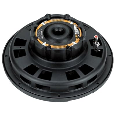

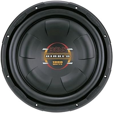

heres the sub i ordered
info on sub http://www.amazon.com/Boss-D10F-10-Inch-Di...boutThisProduct
probally will order a mesh grill to give it a clean look, over a waffle grill
