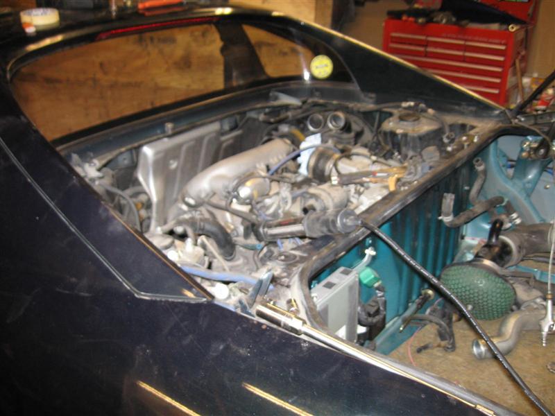

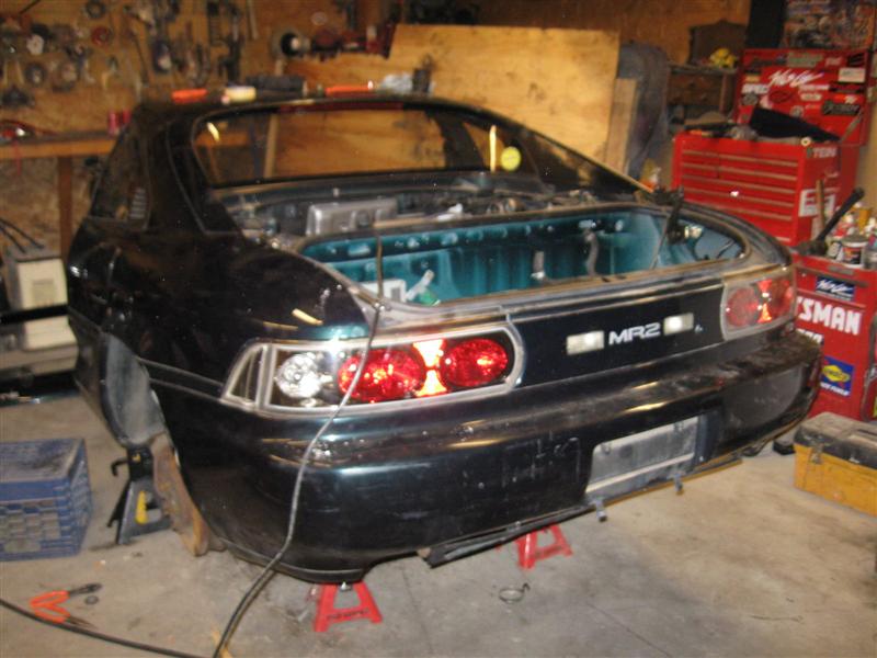

got home from work yesterday, and found this in my garage...
my cousin bought a 3rd gen mr2 clip for his duece.
