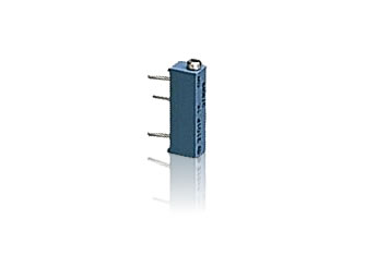

here are a couple links for the parts to build one.
first the potentiometer, PT#271-342
http://www.radioshack.com/product/index.js...oductId=2062307 it costs 2.69$

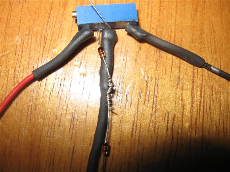

went and got the parts, assembled them, and took some pics.
ill install and test it later when Jenn gets home from work.
the pot
the diodes
here it is assembled.
power wire closest to the adjustment screw, 2 diodes wired in series, with the band at the tops (i forgot to take a pic without the heat shrink, so i just stuck a couple of the diodes in the pic for refrence) and the ground last.

post Aug 29, 2010 - 6:48 PM
so i had the 2 diodes backwards, the black stripe should point down.
i did test it with the diodes the correct way, and it works, but i snapped the pin off the pot before i could solder it all back together.
so ill have to hit radio shack again tommrow and pick up another.
but for under 5 bucks, im sold!
update tommrow night!
