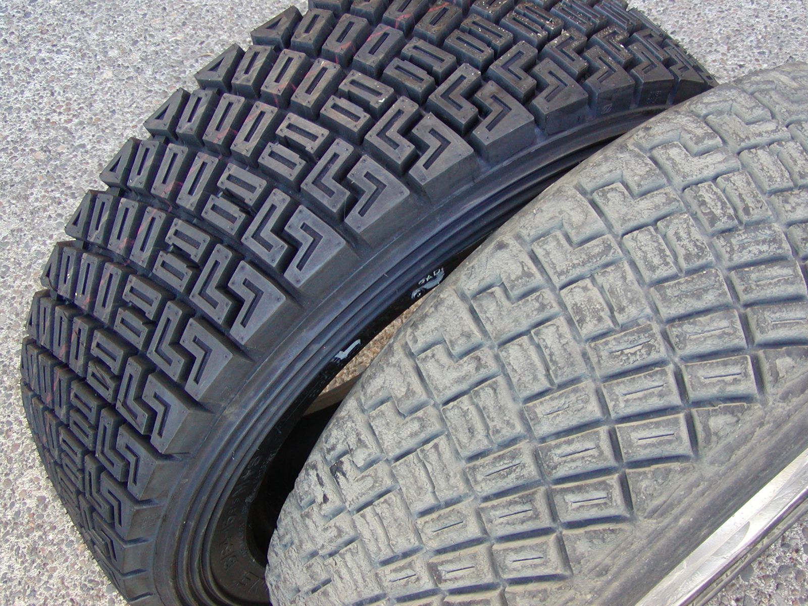

How long does a set of tires last on this car?
2006 Aston Martin V8 Vantage.
1998 Celica GT-
BEAMS Swapped.
2021 GMC Sierra AT4.
post Jun 25, 2013 - 9:17 AM
czwalga
Joined Sep 27, '10
From pittsburgh
QUOTE (richee3 @ Jun 23, 2013 - 4:36 PM) *
For me, hards maybe 3 rallys. Mediums maybe 2. And thats stretching it longer than I probably should. Most guys probably go through a set per longer rally. I'm cheap.
The top end of the field, go through an entire set per service. So basically 30-60 miles, then swap tires. There tires are shredding in that timeframe. You can see how deep the thread is, new they are probably at least double the thickness of stock street tires.
The second pic in the first pic, i'd consider done, or at least close.
These are just trashed.
