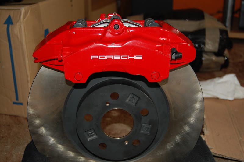

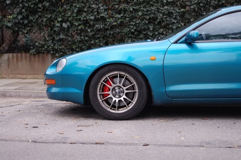

After dropping the idea of using ST205 calipers on a McPherson suspension i searched for radial-mount calipers and found some from Porsche that where perfect, they come from a 996 Turbo/GT3.
I use them with stock Toyota brake discs for the ST205. ![]() ![]() ![]()
Hafkai Porsche brake on a ST Sep 29, 2010 - 3:01 PM

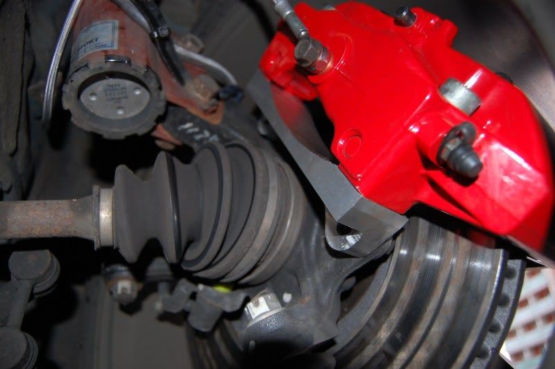

Stambo just one question. Did you have troubles bleeding ... Sep 29, 2010 - 10:22 PM
playr158 Your calipers are on the wrong side.....The bleed ... Sep 29, 2010 - 10:39 PM
Hafkai All Celicas in Germany got ABS and disc brakes in ... Sep 30, 2010 - 4:03 AM
playr158 Maybe you should email Porsche and tell them they ... Sep 30, 2010 - 5:33 AM
Hafkai Porsche does nothing wrong .. here is a pic how t... Sep 30, 2010 - 6:04 AM
