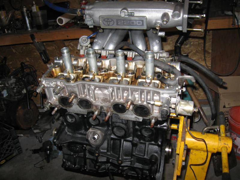

art changed the oil regularly with mobil1, and i did as well, and never had even the slightest buildup of sludge
this is my 98 head, after ~100k miles. (50k of which were turbo'd, but that really dont matter for the purpose of this thread)

Wow looks really clean.
So that's just from using mobil1 oil?
If the engine already had dirt/sludge in it, does the mobil oil also clean it?

You're misunderstanding the point here. Changing your oil regularly at a 3000 mile interval will PREVENT sludge build up. Changing it with a FULL-SYNTHETHIC oil will help out even more, MOBIL 1 for example, a full-synthethic which does a good job cleaning the engine. Now if sludge were already present only was is to do an engine flush.
