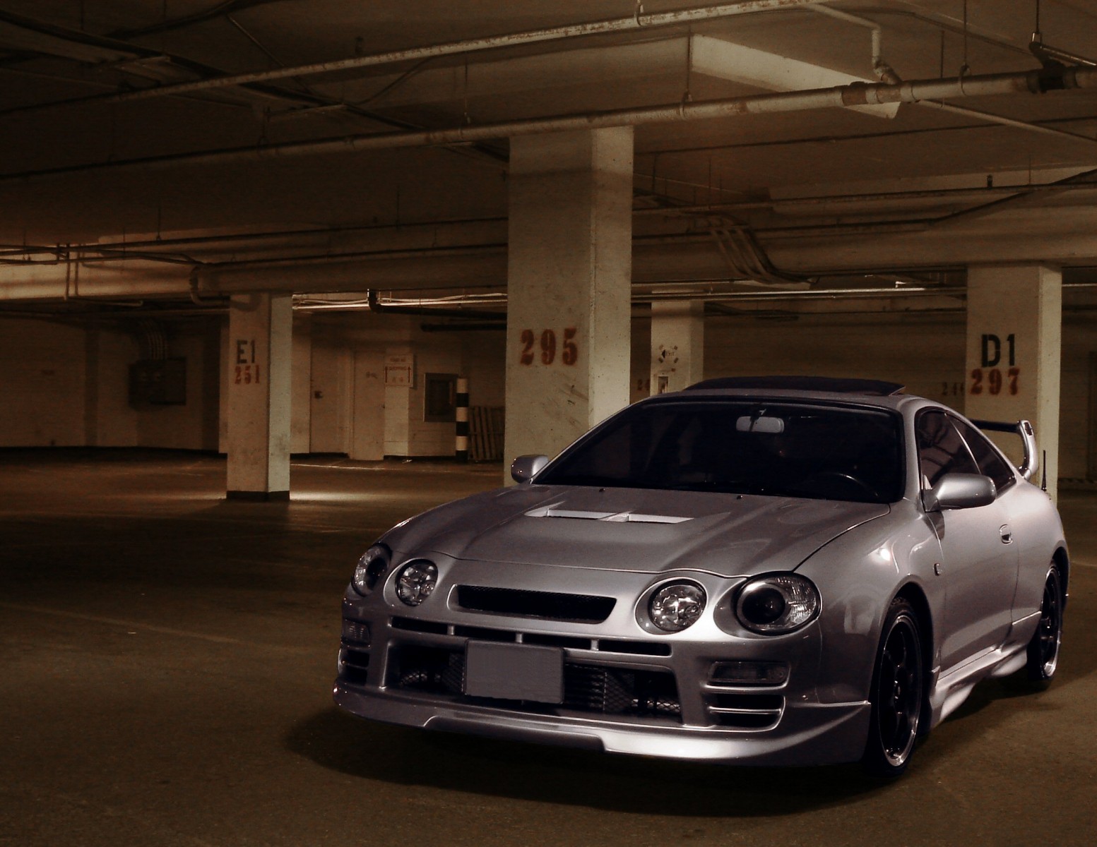

QUOTE (easternpiro1 @ Nov 26, 2010 - 1:46 PM) *
thanks nammer, i been looking for someone that did that! also, did you tint your low beams? looks like it...
i will be blacking mine out as soon as i get them, also for the OP ive always been told putting them in an oven to like 300* gets the glue soft better. (and putting the glass back in to reheat the glue also)
No, they are not tinted...it's probably looks that way due to the lighting and the black housing
To remove the lens, i used a cheap heat gun. heat it up evenly and pry it open gently with a cloth and wide flathead screwdriver...pry slowly bit by bit going around a few times..if you rush it you can chip the glass at the edges...
