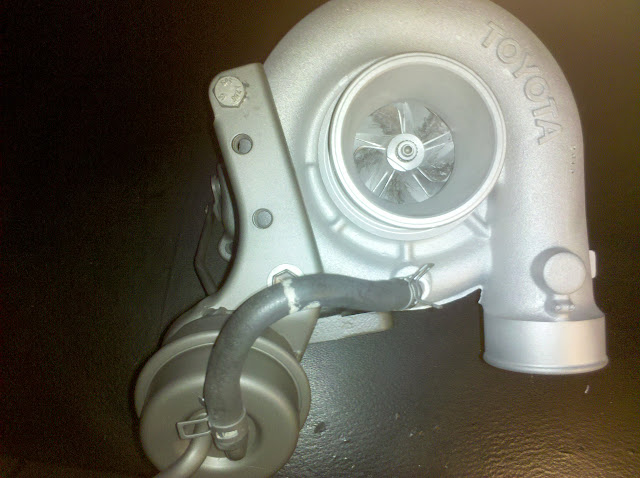

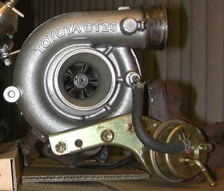

what turbo comes on the 3rd gen celica engines? (ST205)
i keep hearing CT20 and sometimes i hear CT26
which one is it? (for documentation reasons)
and how do you tell the difference between em? (like visual difference, for recognition)

Ct20b
post Nov 25, 2010 - 10:56 AM
yea, technicly, it has the ct-26b or somthing designation...guys like us at some point back in the day started calling it ct-20b to distinguish it i guess.
the easiest way to tell the diffrence is to look at the bolts holes for the downpipe.
a ct-26 has 6.
a ct-20b has 7.

CT20b. the CT26 has "Toyota CT-26" on the side. other than that they look practically the same.

you cant go by the compressor housing. not all ct-26's have that on the side.
in fact, the one i had modded into a ct-27 doesnt.
