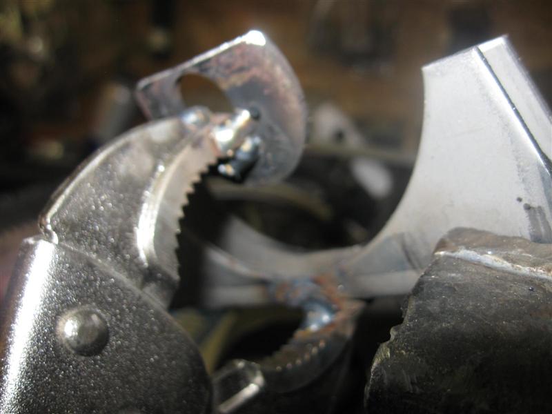

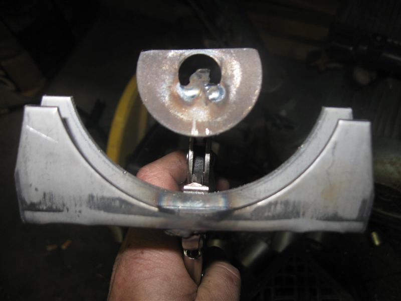

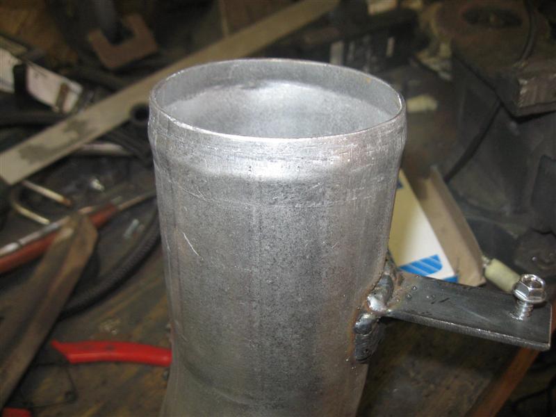

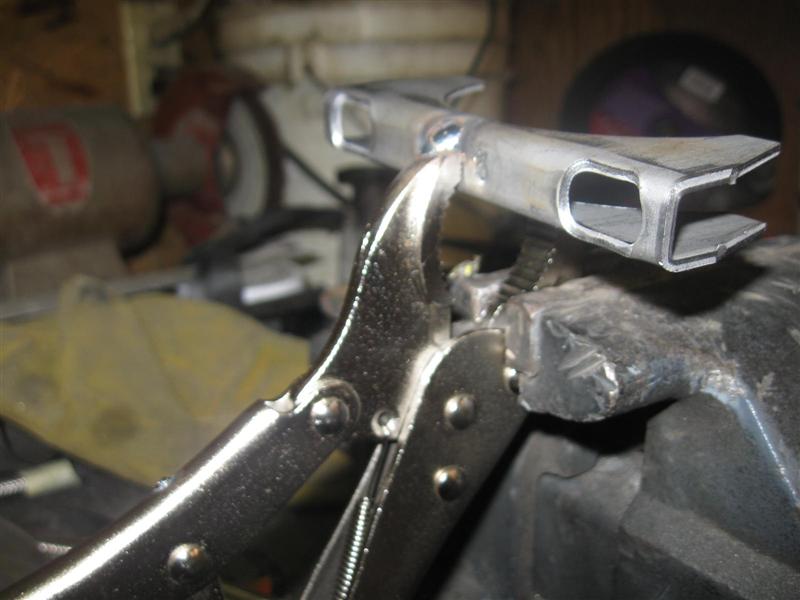

so, i went ahead, and built one from what i remembered.
basicly, you get a set of 10" vice grips (i used a cheapo set from harbor frieght, they were under 4$), an ehxaust clamp for whatever size pipe your beading, (jims is 3", so i got a 3" clamp) and a nice heavy duty washer ( i used one that i had in my "bucket o bolts")
weld it up like this:
you insert it into the pipe, and squeeze it like this:
and you end up with this:
and there you go, bead your pipes for under 10$!!
